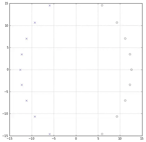

Is there a way to find the roots more directly? They are very nicely structured, I just don't know what that structure is; here is a complex-plane plot of the poles ("x") and zeros ("o") for $p=q=9$:
If I use numpy.roots() (which, again, relies on computing the eigenvalues of the companion matrix), then things seem to be ok for a while but then maybe break down...
