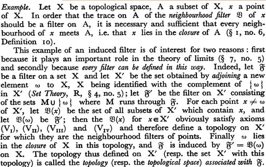

Let $X$ be a topological space. Then a filternet (this is a term I made up) in $X$ consists of a set $I$, a filter $F$ on $I$, and a map $I\to X$ (written $i\mapsto x_i$). We say $(x_i)$ converges to a point $x\in X$ if for each neighborhood $U$ of $x$, $\{i\in I:x_i\in U\}\in F$.
Isn't a filternet merely a continuous map $I\sqcup_{F} \{\infty\}\to X$ where the topology on $I\sqcup_{F} \{\infty\}$ is such that $F$ is the filter of neighbourhoods of $\infty$, and $\infty$ is a closed point, and the induced topology on $I$ is discrete? Explicitly, a subset $U$ of $I\sqcup_{F} \{\infty\}$ is open iff it either $\infty\not\in U$ or $U\setminus\{\infty\}\in F$. By the very definition of continuity, the map $(x_i),x_\infty=x: I\sqcup_{F} \{\infty\}\to X$ is continuous iff for each neighbourhood $U$ of $x$, $\{i\in I:x_i\in U\}\in F$, i.e. $(x_i)$ converges to a point $x\in X$.
This space is defined in Bourbaki, General Topology, \S6.5, Def.5, Example, see the picture above. In \S7.5 they do discuss convergence in terms of the trace filters but do not mention explicitly this construction. And I do not think I havev seen a reference explicitly discussing convergence in terms of these maps.
