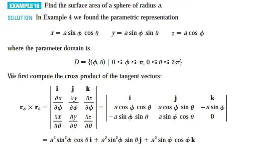

If I take the upper hemisphere of a sphere, $x^2 + y^2 + z^2 = 1$, to be $\sqrt{1 - x^2 - y^2}$, then the normal is given by $\langle -f_x, - f_y, 1\rangle$ at any point.
This leads to an odd result: on the plane $z = 0$, while one might expect all normals of the sphere to not have any $z$ component (i.e, to only point radially outwards), the $\vec{k}$ component is still 1.
A similar parametrization in cylindrical coordinates is:
$\langle \sin(\phi)^2 \cos(\theta), \sin(\phi)^2 \sin(\theta), \sin(\phi) \cos(\phi)\rangle$.
At $\phi = 0$ and $\theta = 0$, which corresponds to the point $(0,0,1)$ in cartesian coordinates, the normal is $\langle 0,0,0 \rangle$ while one would expect $(0,0,1)$.

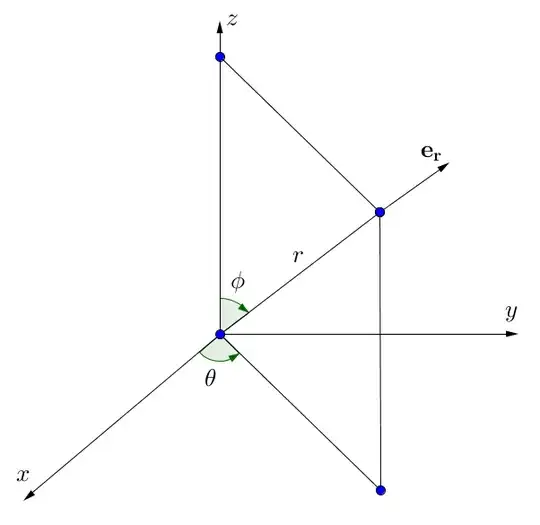

The radial unit vector in spherical coordinate is normal to the surface of unit sphere and it is given by
$${\bf{e}}_r= \sin\phi \cos\theta {\bf{i}}+ \sin\phi \sin\theta {\bf{j}}+ \cos\phi {\bf{k}}$$
and when $\theta=0$ and $\phi=0$ we get
$${\bf{e}}_r= {\bf{k}}$$
so in this case you we have no problems and everything is well-defined.

  • Would you know why ⟨sin(ϕ)2cos(θ),sin(ϕ)2sin(θ),sin(θ)cos(θ)⟩ doesn't work? This can be shown to give the normal if we parametrize $r$ (the surface) to be the standard equations from spherical to cartesian, ⟨sin(ϕ)cos(θ),sin(ϕ)sin(θ),cos(θ)⟩, and then take the cross product: $r_{\theta} \times r_{\phi}$ – Muno Dec 09 '15 at 20:28

  • @Muno: your parameterization is wrong! :) – Hosein Rahnama Dec 09 '15 at 20:41
  • @H.R. I updated my question with the parametrization I had in mind. – Muno Dec 09 '15 at 20:54
  • @DavidK: I added my convention so I assume that it is written correctly. :) – Hosein Rahnama Dec 09 '15 at 20:55
  • @Muno: Again see the updated answer. :) – Hosein Rahnama Dec 09 '15 at 21:32
  • What I meant was, $\langle \sin(\phi) \cos(\theta), \sin(\phi) \sin(\theta), \cos(\theta)\rangle$ (in your comment) is an incorrect parameterization of the sphere. It should be $\langle \sin(\phi) \cos(\theta), \sin(\phi) \sin(\theta), \cos(\phi)\rangle$. In the question, you also had written $\theta$ in a couple of places where it should have been $\phi$, but you have corrected that already, so as long as you don't copy that comment anywhere else I don't think it will cause any trouble. – David K Dec 09 '15 at 22:49

  • @DavidK: Which comment? :) Anyway, my conventions for the angles was exactly the reverse of the thing depicted in my answer unless the OP updated the example in the question so I changed the conventions to match the question. – Hosein Rahnama Dec 10 '15 at 09:56
