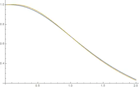

and the correct branch of $\sqrt{}$ must be chosen, which is valid in the limit $n \to \infty, \zeta \to 1$. One can check that this is a very good approximation even for small values of $n$. Here's a plot of the left-hand side of $(4)$ in blue versus the right-hand side in orange for $0 < \zeta < 2$ and $n=2$:

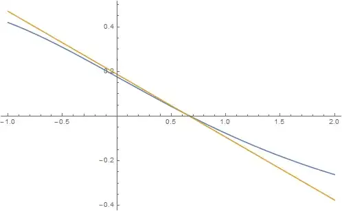

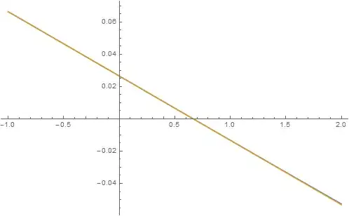

where the error holds uniformly for $z = o(\sqrt{n})$. Below is a plot of $e^{-z-n} p_n(z+n) - 1/2$ in blue versus $(2-3z)/3\sqrt{2\pi n}$ in orange for $0 < z < 1$ and $n=2$:
and for $n=100$:
It then follows that the $o(\sqrt{n})$ roots of the equation

$$ 0 = \frac{2-3z}{3\sqrt{2\pi n}} + o(n^{-1/2}) \qquad \text{as } n \to \infty, $$
and solving for $z$ yields
$$ z = \frac{2}{3} + o(1) \qquad \text{as } n \to \infty. $$
