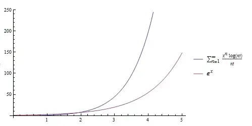

While doing some caculation related to von Neumann entropy, I encountered this kind of convergent series. $$\text{Exl}(x) \equiv \sum _{n=1}^{\infty } \frac{x^n \log (n!)}{n!}$$ In my calculation, this function Exl$(x)$ appears in some places where exponential function should be, for example, $$\frac{\cosh (x) \text{Cxl}(x) + \sinh (x)\text{Sxl}(x)}{\cosh(2x)}$$ appears in my calculation, where $$\text{Cxl}(x) \equiv \frac{\text{Exl} (x) +\text{Exl} (-x)}{2}$$ and $$\text{Sxl}(x) \equiv \frac{\text{Exl} (x) -\text{Exl} (-x)}{2}$$ are defined from the similarity to the hyperbolic functions. As the given function Exl$(x)$ looks like some kind of 'augmented' exponential function as the following plot suggests, enter image description here
I suspect there's a well defined special function related to this series. Is it so? Any kind of suggestion is appreciated.
