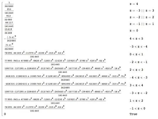

This is what mathematica calculated for $\sum_{i=1}^5 U_i - \sum_{i=6}^{10} U_i$, where $U_i$ are iid Uniform[0,1]:
pdf of $\sum_{i=1}^5 U_i - \sum_{i=6}^{10} U_i$
Calculating the coefficients of the polynomials for these distributions would probably be an interesting combinatorics problem. So in theory you could calculate an exact formula for your distribution and draw from this, but it may be unwieldy if you are adding and subtracting too many times.
On the other hand, the reason this distribution looks sort of normal is because you are adding iid random variables, which by the Central Limit Theorem will result in something that can be better approximated by a normal distribution the more iid random variables you add together. For the distribution you described, the mean is 0 and the variance is 10/12, since each of the 10 independent variables has a variance of 1/12. So a Normal[0,10/12] distribution may be a decent approximation.
