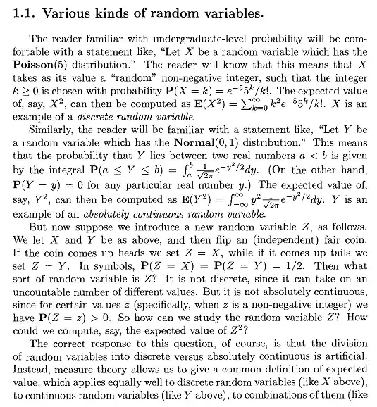

2 reasons why measure theory is needed in probability:
  1. We need to work with random variables that are neither discrete nor continuous like $X$ below:
Let $(\Omega, \mathscr{F}, \mathbb{P})$ be a probability space and let $Z, B$ be random variables in $(\Omega, \mathscr{F}, \mathbb{P})$ s.t.
$Z$ ~ $N(\mu,\sigma^2)$, $B$ ~ Bin$(n,p)$.
Consider random variable $X = Z1_A + B1_{A^c}$ where $A \in \mathscr{F}$, discrete or continuous depending on A.

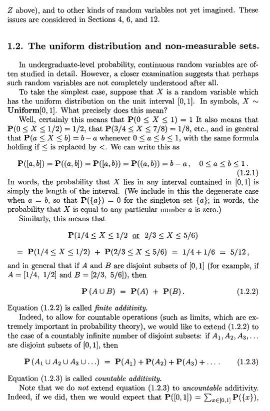

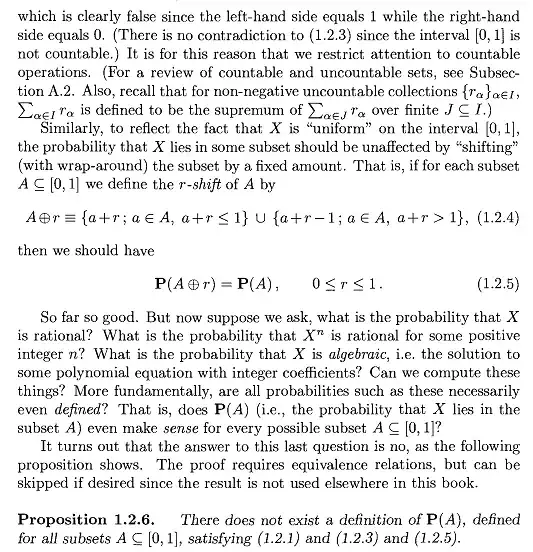

  1. We need to work with certain sets:
Consider $U$ ~ Unif$([0,1])$ s.t. $f_U(u) = 1_{[0,1]}$ on $([0,1], 2^{[0,1]}, \lambda)$.
In probability w/o measure theory:
If $(i_1, i_2) \subseteq [0,1]$, then $$P(U \in (i_1, i_2)) = \int_{i_1}^{i_2} 1 du = i_2 - i_1$$
In probability w/ measure theory:
$$P(U \in (i_1, i_2)) = \lambda((i_1, i_2)) = i_2 - i_1$$
So who needs measure theory right? Well, what about if we try to compute
$$P(U \in \mathbb{Q} \cap [0,1])?$$
We need measure theory to say $$P(U \in \mathbb{Q} \cap [0,1]) = \lambda(\mathbb{Q}) = 0$$
I think Riemann integration doesn't give an answer for $$\int_{\mathbb{Q} \cap [0,1]} 1 du$$.
Furthermore, $\exists A \subset {[0,1]}$ s.t. $P(U \in A)$ is undefined.
From Rosenthal's A First Look at Rigorous Probability Theory:
