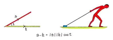

The dot product is used when you want the magnitude of the projection of one vector onto another.
For example, consider a one-armed, very sunburned man who's naked pulling a heavy object along the ground by a cord
In this situation the work done by the man is just the projection of the force ($\vec a$) he's providing onto the direction of motion of the object ($\vec b$) times the distance it travels ($\vec b$). Thus the work is $W=\left[\|\vec a\|\cos(t)\right]\|\vec b\| = \vec a \cdot \vec b$.

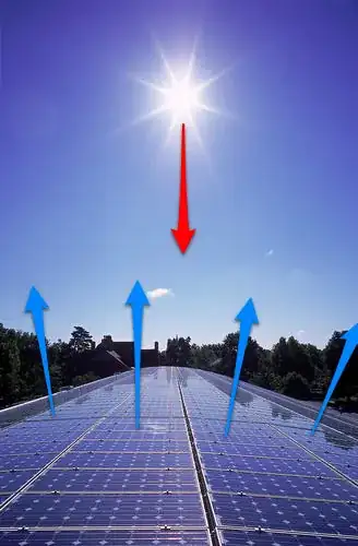

Here's another example, consider a solar panel:
The amount of solar energy absorbed by the panel depends on the angle between the normal vector from the panel and the sun rays. I.e. the energy is proportional to the dot product of the vector pointing from the sun to the panel and the normal vector from the panel. So if the Sun is straight up you'll get the most energy from the solar panel if it is positioned so that it's normal vector is straight up as well. That's why large solar panel banks often have motors that tilt the panels as the Sun is moving across the sky -- that way they get the most energy they can all day long.

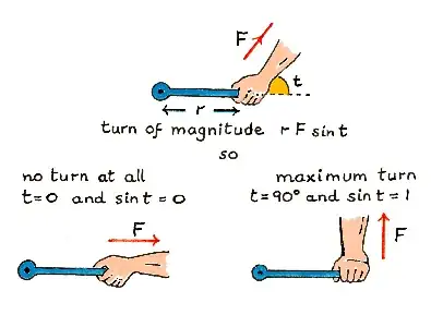

The cross product has two purposes. The magnitude of the vector $\vec a \times \vec b$ is the magnitude of the rejection of $\vec a$ from $\vec b$ times the magnitude of $\vec b$ (compare this to the dot product which gives the magnitude of the projection times distance). And its direction is perpendicular to both $\vec a$ and $\vec b$.
For an application based on the magnitude, consider torque:
The magnitude of the torque on the end of a lever (whose other end is fixed to an object) is given by the rejection of the force vector from the distance vector along the lever times the distance along the lever. So $T = \|\vec F \times \vec r\| = \left[\|\vec F\|\sin(\theta)\right]\|\vec r\|$.

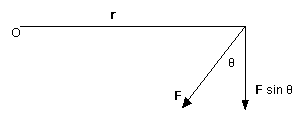

As per your comment,
$x\cdot y$ represents the projection of the current velocity along the speed-boat velocity.
$x\times y$ represents a vector perpendicular to the plane containing $x$ and $y$ and its direction will be determined by the Right Hand Grip Rule.
Edit:
This is the projection of a vector on another i.e. use of dot product.
And for cross product, take this example of how a torque works:
