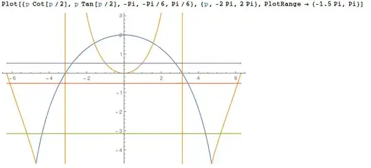

First we reckon $p$ to be real, and plot out the RHS of w.r.t $p$:
When $p=-\pi$, we read out from the graph, $p=2.77168$ and $3.36624$. $z=\pm \cosh p$ give us the four desired root. But the problem is, when $a\in(-2,-\pi/2)$, there seems only one pair of roots from the graph.
When $p=-\pi/6$, we read out from the graph, that $p=1.07018$, $z=\pm i\cosh p=\pm 1.62943 i$, which again give us the desired pair of roots. However, what if $a>0$, for example $a=\pi/6$, can't read out from this graph.
Next we reckon $p=ip_0$:
There are many crossings, read the ones most close to the $y$ axis(I don't have a particular reason).
  • when $p=\pi/6$, $p_0 = 0.980755$ and $z=\pm i\cos p_0 = \pm 0.556395 i$. We get the desired results, but why should I choose the one nearest to the $y$ axis, there are many roots after all. Besides, it seems that from this graph that $a>\pi/2$ we still have solutions, which is not right. I also want to mention that, the intersection of blue and orange lines has the height of $\pi/2$.
  • when $p=-\pi/6$ or $-\pi$, we can never get the right results, for $|\cos p_0| <=1$.
Question is that what's the hidden flaws in this derivation? How can I fix them so that I can get the desired conclusion and results?
