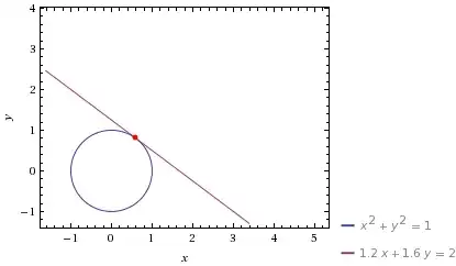

You can do more than $u$ substitutions too; there are other sorts of algebraic and geometric things you can do. e.g. to work in the unit circle, we can take as a given that the two dependent variables $x$ and $y$ satisfy
$$ x^2 + y^2 = 1 $$
from which we infer that
$$ 2x \, \mathrm{d}x + 2y \, \mathrm{d}y = 0 $$
which has various algebraic and geometric content. e.g. we can solve for
$$ \frac{\mathrm{d}y}{\mathrm{d}x} = -\frac{x}{y} $$
or we can quickly determine the tangent line at a point; e.g. the tangent line to $(0.6, 0.8)$ satisfies $1.2 \mathrm{d}x + 1.6 \mathrm{d}y = 0$. Since the tangent line varies in the same way the circle does at a point, the tangent line must have the form $1.2 x + 1.6 y = c$ for some constant $c$. Plugging in the given point gives $1.2 x + 1.6 y = 2$.
plot of circle and tangent line
(plot generated by this wolfram alpha command)
