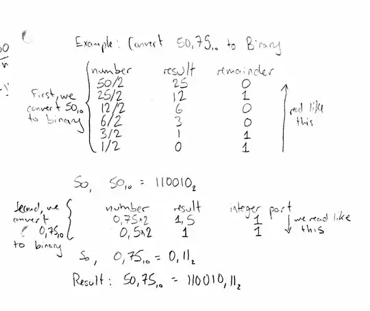

Example: Convert 50.75 (in base 10) to binary.
First step (converting 50 (in base 10) to binary):
  1. We divide 50 by 2, which gives 25 with no remainder.
  2. Next, we divide 25 by 2, which gives 12 with a remainder of 1.
  3. We continue like this until we reach 0.
  4. We read the result from bottom to top (as shown in the picture).
Second step (converting 0.75 (in base 10) to binary):
  1. We multiply 0.75 by 2, which gives 1.5. We keep only the integer part, which is 1. Then, we do 1.5 - 1, which gives 0.5.
  2. We multiply 0.5 by 2, which gives 1. We keep only the integer part, which is 1. Then we do 1 - 1, which gives 0.
  3. We're done. We read from top to bottom (check picture).
This method can also be used to convert a float to octal or hexadecimal. Same methodology.
