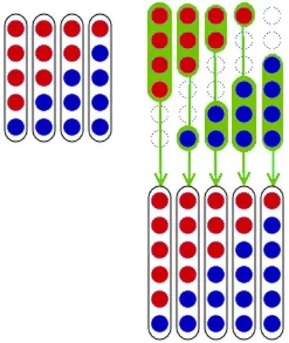

By induction: Assume that the proposition holds true for (say) $m=5$ , where $m=n+1$ is the total number of balls, hence the urns may have $k=1\cdots 4$ red balls with uniform probability. The experiment then can be pictured as this: we have 4 urns, each with 5 balls, the first with $1$ red ball, the second with 2, etc. We pick one of these 4 urns, with same probability, and then we pick a ball with uniform probability from the urn. This is the same as saying that we pick a ball at random, always uniformly, from the total $4\times 5=20$ balls. The following picture helps (I hope) to envision the possible alternatives.
On the left, we have the 4 urns, and the 20 balls, from which we will draw one. On the right, the same balls are arranged with a displacement along the diagonal. In this way we can identify all the balls that, if selected, will lead to each of the new urns (diagram below). Because we have the same number of total balls for each new urn, each one will have the same probability.

  • a very cool pictorial illustration! – Michael G Sep 19 '15 at 01:24
