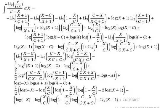

$$J{\left(a,c\right)}=\operatorname{Li}_{2}{\left(\frac{c}{1+c}\right)} \left(\frac{-1}{a} \ln \frac{a-c}{c} \right) -\int_{0}^{1}\mathrm{d}y\,\frac{\operatorname{Li}_{2} \left(\frac{ay}{1+ay}\right)}{c-ay}$$ With change of variables : $X=ay$ and $C=c/a$ : $$\int_{0}^{1}\mathrm{d}y\,\frac{\operatorname{Li}_{2} \left(\frac{ay}{1+ay}\right)}{c-ay}= \frac{1}{a}\int_{0}^{1/a}\mathrm{d}X\,\frac{\operatorname{Li}_{2} \left(\frac{X}{1+X}\right)}{c-X}$$
For the last integral, WolframAlpha gives an huge result :
