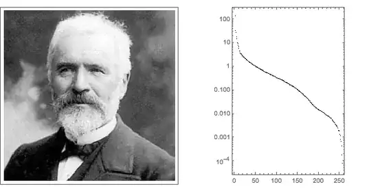

Matrix rank is a nuanced subject in numerical linear algebra because of errors in the finite binary representation of real numbers. In theory the matrix rank $\rho$ has a crisp definition. In computation, the numerical rank is often set using a threshold.
The following image of Camille Jordan is a 256 $\times$ 256 matrix of grayscale values $[0,1]$. The singular value spectrum spans seven orders of magnitude. In this example, the smallest value is much larger than machine epsilon.
However, more demanding spectra will have values near machine epsilon. The question is then whether a small number is a numeric zero or a legitimate member of the spectrum.
camille

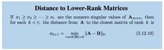

In practice, you might clip any singular values below, say, $10^{-11}$. In Meyer's book, p. 417, he shows how the singular values quantify how close the target matrix is to a matrix of higher rank. When the singular value is small, the target matrix is close to a matrix of higher rank.
