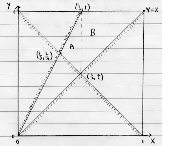

My preferred solution is to let the cuts be at $X, Y$, with $Y \gt X$:
Image of cut positions
Then each piece is equally likely to be the longest, and the expected length of the longest piece doesn't depend on which piece we choose. Then we can calculate $\mathop{\mathbb{E}}(X|X \text{ is the longest piece} )$.
We have the three inequalities: $$X \gt Y-X \implies Y < 2X$$ $$X \gt 1-Y \implies Y > 1-X$$ and, from our setup, $$Y \gt X$$ These can be represented by the following diagram:
Diagram of inequalities
Then the area satisfying our inequalities is the two triangles A and B. So we wish to find the expected value of $X$ within this area.
The expected value of $X$ in A is $\bar{X}_A = \frac{1}{2}-\frac{1}{3}(\frac{1}{2}-\frac{1}{3}) = \frac{8}{18}$.
The expected value of $X$ in B is $\bar{X}_B = \frac{1}{2}+\frac{1}{3}(\frac{1}{2}) = \frac{4}{6} = \frac{12}{18}$
The area of A is $A_A = \frac{1}{2} \times \frac{1}{2}\times (\frac{1}{2}-\frac{1}{3}) = \frac{1}{24}$.
The area of B is $A_B = \frac{1}{2} \times \frac{1}{2}\times \frac{1}{2} = \frac{1}{8} = \frac{3}{24} = 3 A_A$.
So $\mathop{\mathbb{E}}(X|X \text{ is the longest piece} ) = \frac{\tfrac{8}{18} + 3\left(\tfrac{12}{18}\right)}{4} = \frac{11}{18}$

  • Could you explain how you get to the expected value of X in A and B and more specifically how you get to the 1/3 in front of the parentheses? I can derive it by calculating it via integration over the area, but you seem to use a shortcut. – Hans-Peter Schrei Apr 16 '19 at 20:47
    I used the fact that, for a triangle, the centre of area is 1/3 of the way from the base to the opposite point. I guess that's most easily seen by integration. – Ronnie268 Apr 18 '19 at 12:10
  • How did you find the point (1/3,2/3) drawn on your diagram? – Karina Nov 11 '21 at 15:13
  • It's the intersection of $Y=2X$ and $Y = 1 - X$, so $2X = 1 - X$, whence $X = 1/3$ – Ronnie268 Nov 12 '21 at 16:25
  • Apologies for the correction but Ronnie268, your answer is incorrect: (1) Small calculation mistake in the last step, denominator should be 24: (| is the longest piece) $= \frac{ \frac{8}{18}+3(\frac{12}{18})} {24 (not 4)}$ $ = \frac{1}{6}(\frac{11}{18})$ (2) I think the rest of the expected value is missed because you didnt calculate ( Y-X |Y-X is the longest piece) and ( 1-Y | 1-Y is the longest piece ). – Ashwin Samuel Jun 30 '23 at 01:25
  • @Ashwin No, Ronnie268 is correct. The denominator is 4 because it's the sum weighting. Area of A is $A_A$ while area of B is $3A_A$, so their total area is $4A_A$. – regulus Dec 07 '23 at 18:30
  • This answer is great. Can someone help me understand why the expected value of $X$ in $A$ is $8/18$? – user1887919 Aug 16 '24 at 04:13
