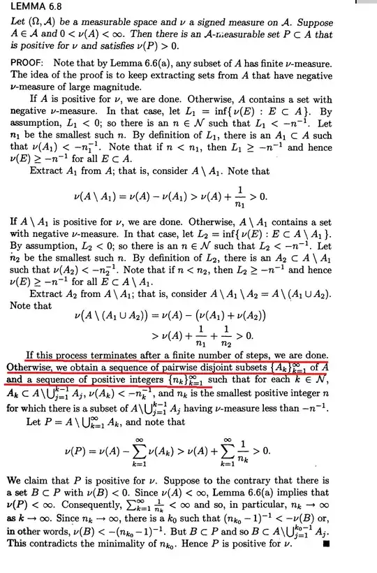

Here is the example of the proof that uses property 1. It is from measure theory, and all the details are not important for this question, the only thing that is important for this question is why he can say what he says where I have marked in red:

Your property 1 is effectively the Recursion Theorem. It is often (sloppily) referred to as an "inductive procedure," which is to some extent reasonable, because we need the Principle of Mathematical Induction (or, equivalently, the well-ordering property of the natural numbers) to prove it.
The rough idea is that if we can start a procedure, and explicitly state (1) under what conditions the procedure must stop and (2) how specifically to proceed to the next step if said conditions aren't met in a given step, then either the process is well-defined, and proceeds for a (possibly finite) sequence of steps. (As user21820 aptly points out, we must do more than simply state the above. We must prove that we can start the procedure, and that we can continue so long as the conditions for stopping aren't met.)

  • This is not enough. Just because you can extend a sequence to any arbitrary finite length does not mean that you can obtain the infinite sequence! Moreover, depending on how you do it, you may need some kind of choice axiom. See for example http://math.stackexchange.com/a/717963/21820 for some details. – user21820 Aug 27 '15 at 02:58
  • You are incorrect. Note the use of the word "deterministically." By this, I mean that there is a function $f$ such that, given some $a_n$ that does not meet the conditions for termination, we define $a_{n+1}:=f(a_n).$ This uses the Recursion Theorem, and no choice is required. – Cameron Buie Aug 27 '15 at 03:00
    Okay sorry I misinterpreted your use of "deterministically" since you said "deterministically say" rather than "say ... how to proceed deterministically ...". The former might mean you "deterministically prove the ability to proceed". If you edit it I can change my vote. – user21820 Aug 27 '15 at 03:03
  • Does that change in wording make it less ambiguous? – Cameron Buie Aug 27 '15 at 03:05
  • Thank you, by the way, for pointing out the ambiguity! I had not considered that interpretation. – Cameron Buie Aug 27 '15 at 03:08
  • Yup I think it's clearer now. – user21820 Aug 27 '15 at 03:09
