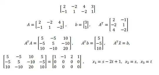

I'm doing problems from old exams, and my solutions don't add up with the professor's solution. The problem is as followed: Find all least squares solutions of the linear system. I checked my calculations are correct, I checked with my TI-82 STATS calculator and used the correct formulas. Can you check if this is correct or not?
  • Of course, finding least squares solutions of this linear system makes sense because of the inconsistency – Dick Armstrong Aug 26 '15 at 20:23
  • Looks good to me. What is your professor's solution? – user1551 Aug 26 '15 at 22:38
  • $(1 0 0)^T + s(1 1 0)^T + t(2 0 1)^T$, I cannot figure how he got positive 2 instead of -2, it should say $t*(-2 0 1)^T$ – Dick Armstrong Aug 26 '15 at 22:44
    Your solution is correct. Your professor's must have a typo because $A\pmatrix{2\ 0\ 1}\ne0$. – user1551 Aug 26 '15 at 22:48
    Ah if so, I was going insane, thank you! I actually learned more by trying to figure out what I was doing wrong than his actual classes, and never thought about doing $A*(-2 0 1)^T=0$, would have saved me time. Thank you very much! – Dick Armstrong Aug 26 '15 at 22:55

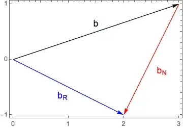

Use projection to find $\color{blue}{b_{\mathcal{R}}}$
Because of the simplicity of the problem, it's easy to find the solution using projections. The trick is to resolve the data vector in range and null space components: $$ b = \color{blue}{b_{\mathcal{R}}} + \color{red}{b_{\mathcal{N}}}, $$ as seen in the following plot.
b resolution
The vector $\color{blue}{b_{\mathcal{R}}}$ is projection of the data vector $b$ onto $\color{blue}{\mathcal{R}(\mathbf{A})}$. Pick a vector in the span, $$ \color{blue}{s} = \color{blue}{\left[ \begin{array}{r} 2 \\ -1 \end{array} \right]} $$ Compute the solution vector $$ \color{blue}{b_{\mathcal{R}}} = b \cdot \frac{\color{blue}{s}}{\lVert \color{blue}{s} \rVert} = \color{blue}{ \left[ \begin{array}{r} 2 \\ -1 \end{array} \right]} $$
