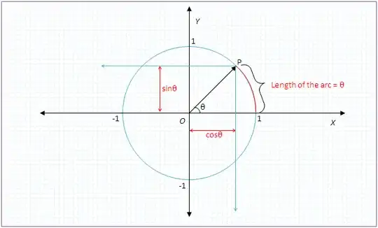

  • Yes, you can visualize it using a diagram. I have uploaded a diagram and explanation. However, this can't be called a 'proof', because a proof needs to be rigorous. – voyager Aug 26 '15 at 07:25

On the unit circle, $\theta$ is the length of the arc (as well as the angle extended by that arc). (Thus, perimeter of the unit circle is $2\pi$). Whereas, $\cos\theta$ is the length of the $X$ intercept, and $\sin\theta$ is the length of the $Y$ intercept.
Look at the following diagram: enter image description here
You can now easily visualize that when Point P approaches closer to $(1,0)$, then $\theta \rightarrow \ 0$. At this time, the arc in question will become almost a vertical line, and the $Y$ intercept of the arc is almost the same length as the arc.
Hence as $\theta \rightarrow \ 0$ then $\sin\theta \rightarrow \theta$
And, at that time, the length of the $X$ intercept will get closer and closer to $1$.
Hence as $\theta \rightarrow \ 0$ then $\cos\theta \rightarrow 1$
Also, from this figure, you can easily visualize that when Point P approaches $(0,1)$, the $Y$ intercept will approach $1$ and the $X$ intercept will have same length as the length of the remaining part of the arc (from point P to point $(0,1)$) which is $(\frac{\pi}{2} - \theta)$. (Remember that total length of the arc from $(1,0)$ to $(0,1)$ is $\frac{\pi}{2}$).
Thus, we have:
$\theta \rightarrow \frac{\pi}{2}$ then $\sin\theta \rightarrow 1$, and
$\theta \rightarrow \frac{\pi}{2}$ then $\cos\theta \rightarrow (\frac{\pi}{2}-\theta)$

voyager
  • 121
  • Why do you consider the length of arc to be $\theta$? – Aneek Aug 26 '15 at 07:27
    I am not considering the length of the arc to be $\theta$, actually it is a fact. The length of the arc of the unit circle IS taken as the angle extended by that arc, this is called Radian angle. Please refer to this: https://en.wikipedia.org/wiki/Radian. Thus, $90\textdegree$=$\frac{\pi}{2}$, and $180\degree$=$\pi$, and $270\degree$=$\frac{3\pi}{2}$, and $360\degree$=$2\pi$, and so on... – voyager Aug 26 '15 at 07:33
  • Let me guess, is an unit circle is a circle of radius 1 unit? – Aneek Aug 26 '15 at 07:34
  • Yes, dear friend! A unit circle is a circle of radius 1, that's why we call it Unit Circle. That's why it intersects $X$ axis at $(1,0)$, and $(-1,0)$, and it intersects $Y$ axis at $(0,1)$, and $(0,-1)$. – voyager Aug 26 '15 at 07:41
  • Oh thanks, I got it.. – Aneek Aug 26 '15 at 07:41
    @voyager Apparently there is no \degree or \textdegree command in the TeX implementation on MSE. You migh use superscript circle instead — 2^\circ renders as $2^\circ$ – CiaPan Aug 26 '15 at 08:03
  • @CiaPan,, yes I was searching on various websites and trying to get the desired output. But after I experimented with a few suggestions, time ran out and my comment was blocked for further editing... You know StackExchange allows editing a comment within 5 minutes only. – voyager Aug 26 '15 at 08:41
  • @voyager When in doubt, I usually experiment with a draft answer, which has an instant preview and no time limit, and cut-and-paste to a comment space when done. :) EOT? – CiaPan Aug 27 '15 at 08:16
  • @CiaPan, thanks a lot for this helpful tip. I am a new user, and getting my head around... EOT! :-) – voyager Aug 27 '15 at 10:18
