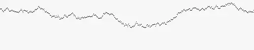

Just to extend a perfect comment by Qiaochu to a more striking example, the sample path of a Brownian motion is continuous but nowhere differentiable: Brownian scaling
Note also that this curve exhibits self-similarity property, so if you zoom it, it looks the same and never will look any similar to a line. Also, the Brownian motion can be considered as a measure (even a probability distribution) on the space of continuous functions. The set of differentiable functions has this measure zero. So one can say that it is very unlikely that a continuous function is differentiable (I guess, that is what André meant in his comment).

    Your graph doesn't look to me like the usual Brownian motion: the variance of $y(x+h) - y(x)$ appears to be increasing as $x$ increases. – Robert Israel May 03 '12 at 17:44
  • @Robert: I changed the illustration, took it from Wikipedia's article on Wiener process. Hope that it shows that zooming does not lead us to a line. – SBF May 04 '12 at 09:49
