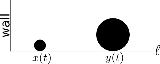

First, let's set up the problem as shown below:
Billiard Ball Step 1
Place the large ball of mass $M$ on the line $\ell$, and place the small ball of mass $m$ between the large ball and the wall. Let the distance of the small ball from the wall at time $t$ be given by the function $x(t)$, and let the distance of the large ball from the wall be given by the function $y(t)$. Now this gives us a way of representing the position of both balls as a point $P(t)=(x(t),y(t))$ in the Cartesian plane, $\mathbb R ^2$.

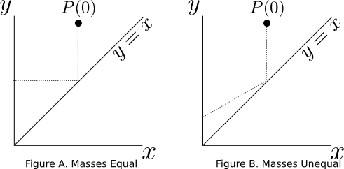

Play around with this a bit to recognize what various parts of the plane correspond to. First, since the little ball is always between the large ball and the wall, $x(t)\le y(t)$ and so the point $P(t)$ will be between the $y$-axis and the line $y=x$. For instance, when the little ball hits the wall, then $x(t)$ will be zero, and so the point $P(t)$ will be on the $y$-axis. When the large ball hits the little ball, then $y(t)=x(t)$ so the point will be on the line $y=x$. This gives us a good way of visualizing all activity in the system as the movement of a point in the two dimensional plane.

This is 3 bounces, which happens to be the first digit of $\pi$. The point $P(t)$ will follow the dotted path outlined in Figure A. Since the masses were equal, note that we have a very nice reflective property of the path of $P(t)$, that is, the angle of incidence is equal to the angle of reflection when it "bounces" against $y=x$ and the $y$-axis. If the masses are unequal, however, this reflective property does not hold because the "large" ball will keep moving with some velocity toward the wall (see Figure B.).

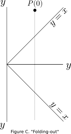

To explain why this reflective property is desirable, let's "fold-out" the angle between the $y$-axis and the line $y=x$ for the case when the masses are equal, as shown in Figure C. (Think of flipping the angle over on itself in a clockwise manner.)
The dotted line still represents the movement of $P(t)$, but every time it would have bounced off of an object, this time it passes into the next folded-out section of the angle instead. Because the angle of incidence is equal to the angle of refraction, we have that the path of $P(t)$ is just a nice straight line, and it is very easy to see that it bounces three times. If only we could get the reflective property to hold when the masses were different sizes...

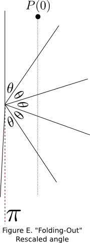

Well, as it turns out (and this does require some math to verify), we can get the reflective property to hold when the masses are different sizes by scaling the graph differently in the $y$ and $x$ directions. First, verify yourself that the ball bouncing against the $y$-axis always has the reflective property, and note that it doesn't matter how you scale the graph (stretch it in the $y$ or $x$ direction, and the bounce of $P(t)$ against the $y$-axis will still be reflective). Thus we only have to scale it in a way so that the bounce off the $y=x$ line is reflective. If you think about it, scaling the graph with different scales for the $x$ and $y$ axis will be akin to changing the angle of the $y=x$ line, and so what we want to do is "rotate" the $y=x$ line to a point where the reflective property holds. As it turns out, and again this does require some math to verify, the proper choice of scaling is $Y=\sqrt M y$ and $X=\sqrt m x$.
This scaling changes the angle between the $y$-axis and the line that represents a bounce between the two balls, which is now $Y=\sqrt{\frac M m}X$. Take the point $Y=\sqrt M$ and $X=\sqrt m$ which is on this line, and note that the triangle thus created by the points $(0,0)$, $(0,\sqrt M)$, and $(\sqrt m, \sqrt M)$ yields that $\tan(\theta)=\sqrt {\frac m M}$. Now, let's "fold-out" the angle, which now has the reflective property:
It's no matter that this angle doesn't perfectly divide $\pi$ (Ahah! There it is!), we do note however that the resulting "folding-out" of an angle will make $\left \lceil \frac \pi \theta \right \rceil$ copies of the angle, and therefore the line $P(t)$ will intersect $\left \lfloor \frac \pi \theta \right \rfloor$ lines. This is why the number that comes out is related to $\pi$!
Now the punchline: we have that $\tan \theta = \sqrt \frac m M$, so $\theta = \arctan \sqrt {\frac m M}$. When we set $M = 100^N m$ for some $n\in \mathbb N$, we have that
$$\theta = \arctan \sqrt {\frac m {100^N m}} = \arctan \sqrt {100^{-N}}=\arctan {10^{-N}}$$
And therefore $P(t)$ will intersect $\left \lfloor \frac \pi {\arctan 10^{-N}} \right \rfloor$ lines, which is exactly the same as saying the system will have exactly $\left \lfloor \frac \pi {\arctan 10^{-N}} \right \rfloor$ collisions. Now Galperin argues that
