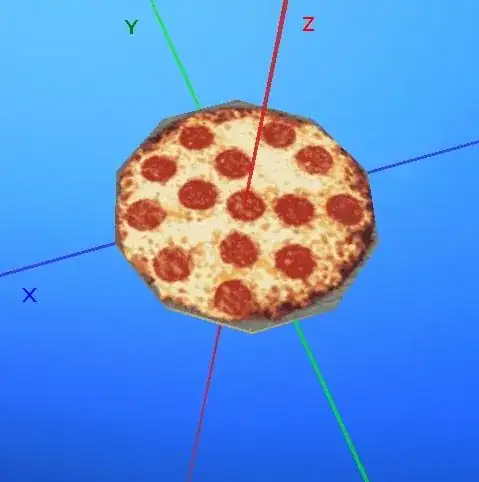

First, here is my pizza: Imgur

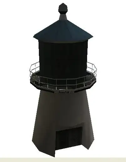

Second, a light house in a full view: Imgur

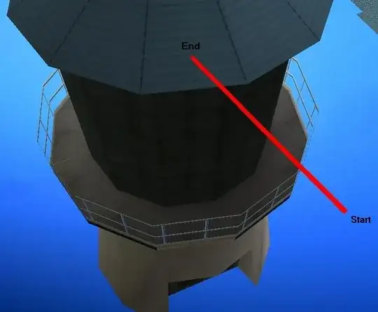

Last, how I want to cast the ray (let the red line be the ray): Imgur
I want to be able to set the pizza's angles (in XYZ, axis's shown above) so that the pizza lays on the roof of the light house using the rotation information (normal) retrieved from bullet's ray-cast.

  • So... you want to rotate the pizza so that its $z$ axis lies along the surface normal, is that right? –  Jul 27 '15 at 18:24
  • Well, yeah. All of the axes need to be rotated. – Corey Iles Jul 27 '15 at 18:39
  • Aren't the axes of the pizza underdetermined? You can spin it on the roof around the pizza's (rotated) $z$-axis so that it remains lying on the roof, right? IOW there are infinitely many ways to pick the direction of pizza's $x$-axis while keeping its $z$-axis normal to the roof. The $y$-axis is then determined by the right handed rule. Yet in other words: in addition to just pepperoni you need to place a single olive on the pizza (not in the center!), and declare that the $x$-axis goes through the olive. And then you need to specify where the olive direction is on the roof. – Jyrki Lahtonen Jul 27 '15 at 19:21
  • Good point. The pizza may've been a bad example since it is circle. No matter what it's Z angle is, as long as it's X and Y are correct it will still lie on the roof. That's where my main problem is, X and Y. My current method is only correct when the ray is straight down. I want to be able to cast a ray any direction and get the correct angles from the normal. For example, in the picture with the red ray cast toward the roof; the angles returned will have the pizza half way in the roof because the X and Y are wrong. If the ray was straight down the angles would be correct. – Corey Iles Jul 27 '15 at 19:51
