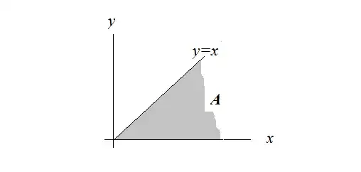

The domain of the integration can be visualized:
Considering the definition of $\mu$ and the shape of the domain, and referring to Fubini's theorem, the double integral above can be written as
$$\int_{0}^{+\infty}\int_{y}^{+\infty}\ 1\ f_Y(x)\ dx\ dy=$$ $$=\int_{0}^{+\infty}P(Y\ge y)\ dy.$$
