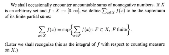

Observe this definition from Folland's real analysis book:

    Under this definition with $f(x) \geq 0$ for all $x \in X$, we get $\sum_{x \in X} f(x) = \infty$ whenever there are uncountably many $x \in X$ such that $f(x)>0$. – Michael Jun 28 '15 at 17:17
    Indeed, that's Folland's next statement :) (image link) – Zev Chonoles Jun 28 '15 at 17:20
