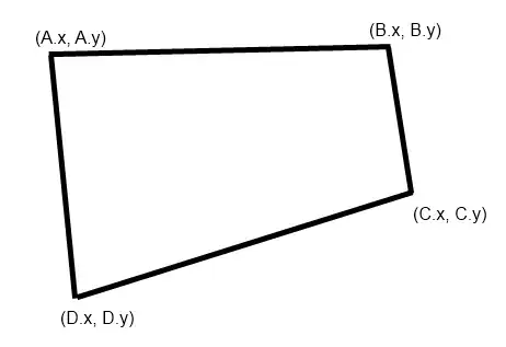

I have a camera looking at a computer monitor from varying angles. Since the camera is a grid of pixels, I can define the bounds of the monitor in the camera image as: alt text
I hope that makes sense. What I want to do is come up with an algorithm to translate points within this shape to this: alt text
I have points within the same domain as ABCD, as determined from the camera, but I need to draw these points in the domain of the monitor's resolution.
Does that makes sense? Any ideas?

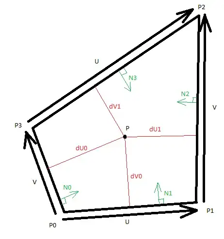

The best solution I've found so far on a forum lost in the sea of forums is to decompose your problem like this :
Here, U and V represent coordinates within the quadrilateral (scaled between 0 and 1).
From $P0$, $P1$, $P2$ & $P3$ we can easily compute the normalized normal vectors $N0$, $N1$, $N2$ & $N3$. Then, it's easy to see that : $$u = \frac{dU0}{dU0 + dU1} = \frac{(P-P0) \cdot N0}{(P-P0).N0 + (P-P2) \cdot N2} \\ v = \frac{dV0}{dV0 + dV1} = \frac{(P-P0) \cdot N1}{(P-P0).N1 + (P-P3) \cdot N3}.$$
This parametrization works like a charm and is really easy to compute within a shader for example. What's tricky is the reverse: finding $P(x,y)$ from $(u,v)$ so here is the result:
$$x = \frac{vKH \cdot uFC - vLI \cdot uEB}{vJG \cdot uEB - vKH \cdot uDA}, \\ y = \frac{vLI \cdot uDA - uFC \cdot vJG}{vJG \cdot uEB - vKH \cdot uDA},$$
where: $$uDA = u \cdot (D-A), \quad uEB = u \cdot (E-B), \quad uFC = u \cdot (F-C), \\ vJG = v \cdot (J-G), \quad vKH = v \cdot (K-H), \quad vJG = v \cdot (J-G),$$
and finally: $$A = N0_x, \qquad \qquad B = N0_y, \quad C = -P0 \cdot N0, \qquad \\ D = N0_x + N2_x, \quad E = N0_y + N2_y, \quad F = -P0 \cdot N0 - P2 \cdot N2, \\ G = N1_x, \qquad \qquad H = N1_y, \quad I = -P0 \cdot N1, \qquad \\ J = N1_x + N3_x, \quad K = N1_y + N3_y, \quad L = -P0 \cdot N1 - P2 \cdot N3.$$
I've been using this successfully for shadow mapping of a deformed camera frustum mapped into a regular square texture and I can assure you it's working great! :D

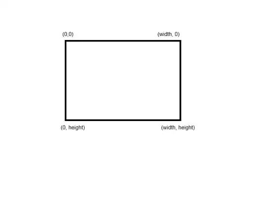

You could approach this by using an isoparametric mapping. Say the quadrilateral object is said to be in a $x_{1}-y_1$ coordinate frame, while the rectangle is in a new $x_{2}-y_{2}$ frame. What you can do is find $x_{1}=x_{1}(x_{2},y_{2})$ and $y_{1}=y_{1}(x_{2},y_{2})$ using an interpolation-based mapping.
Say we define each vertex as a 2D vector $\vec{P}_{i}$, we can end up with the following mapping to find an a given $\vec{P}$ as a function of $x_{2}$ and $y_{2}$:
$$ \vec{P}(x_{2},y_{2}) = \sum_{i=1}^{4}\vec{P}_{i}h_{i}(x_{2},y_{2})$$
Now, assume point A, $\vec{P}_{1}$, corresponds with $(0,0)$ location, point B, $\vec{P}_{2}$, corresponds with $(width,0)=(w,0)$, etc. With that, we can arrive at the following expressions for $h_{i}$:
$$h_{1}(x_{2},y_2) = \frac{(x_{2}-w)(y_{2}-h)}{wh}$$
$$h_{2}(x_{2},y_2) = \frac{x_{2}(h-y_{2})}{wh}$$
$$h_{3}(x_{2},y_2) = \frac{x_{2}y_{2}}{wh}$$
$$h_{4}(x_{2},y_2) = \frac{(w-x_{2})y_{2}}{wh}$$
Using all this information, you could loop through the rectangle to find the $\vec{P}$ coordinate in the original image that each $(x_2,y_2)$ pixel is associated with, then get the pixel information and drop it into the $(x_2,y_2)$ pixel. As a note, the $h_i$ expressions were found via Lagrangian interpolation procedures.

Building off of @Patapom's answer, the goal is to find the $\mathbf{p}$ in image space corresponding to an arbitrary u,v. Starting from the transform:
$u = \frac{(\mathbf{p}-\mathbf{p_{0}}) \cdot \mathbf{n}_{0}}{(\mathbf{p}-\mathbf{p_{0}}).\mathbf{n}_{0} + (\mathbf{p}-\mathbf{p_{2}}) \cdot \mathbf{n}_{2}} \\ v = \frac{(\mathbf{p}-\mathbf{p_{0}}) \cdot \mathbf{n}_{1}}{(\mathbf{p}-\mathbf{p_{0}}).\mathbf{n}_{1} + (\mathbf{p}-\mathbf{p_{3}}) \cdot \mathbf{n}_{3}}.$
We can isolate $\mathbf{p}$, and rewrite the equality as $A\mathbf{p}=\mathbf{b}$, where:
$ A \equiv \begin{bmatrix} u \mathbf{n}_{2}^{\top}-(1-u) \mathbf{n}_{0}^{\top} \\ v \mathbf{n}_{3}^{\top}-(1-v) \mathbf{n}_{1}^{\top} \end{bmatrix} $
$ b \equiv \begin{bmatrix} u \mathbf{p}^{\top}_{2}\mathbf{n}_{2} - (1-u)\mathbf{p}^{\top}_{0}\mathbf{n}_{0} \\ v \mathbf{p}^{\top}_{3}\mathbf{n}_{3} - (1-v)\mathbf{p}^{\top}_{0}\mathbf{n}_{1} \end{bmatrix} $
Since A is a 2x2 matrix it can analytically inverted to solve for $\mathbf{p}$. Here's an example python routine:
def map_uv_to_xy(u, v, P, N):
    nu = 1 - u
    nv = 1 - v
    A_11 = u*N[2][0]-nu*N[0][0]
    A_12 = u*N[2][1]-nu*N[0][1]
    A_21 = v*N[3][0]-nv*N[1][0]
    A_22 = v*N[3][1]-nv*N[1][1]
    b_0 = u*(P[2][0]*N[2][0] + P[2][1]*N[2][1])-nu*(P[0][0]*N[0][0] + P[0][1]*N[0][1])
    b_1 = v*(P[3][0]*N[3][0] + P[3][1]*N[3][1])-nv*(P[0][0]*N[1][0] + P[0][1]*N[1][1])
    x = b_0* A_22 + b_1*-A_12
    y = b_0*-A_21 + b_1* A_11
    det_A = A_11*A_22 - A_12*A_21
    return x/det_A, y/det_A

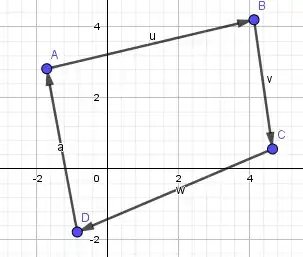

HINT
$A,B,C,D$ are not in the same plane.
A very approximate rectangular projection ratio ... by area projections with extended boundary length), may be obtained considering boundary vector lenghts.
$$\frac{\frac12(|u \times v|+|w \times a|)}{(|u|+|v|+|w|+|a|)^2}$$
The rectangle can be now re-sized.

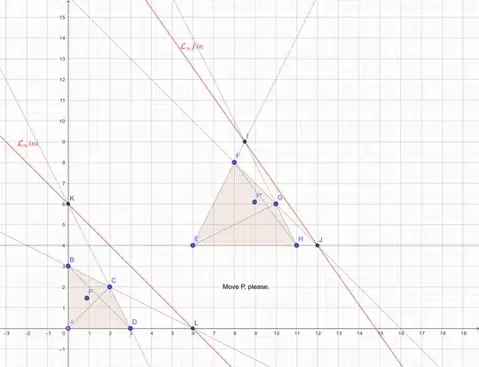

Here is a sagemath program
def collineation(A,B,C,D,E,F,G,H):
    pinfini1=(A.cross_product(B)).cross_product(C.cross_product(D))
    pinfini2=(B.cross_product(C)).cross_product(A.cross_product(D))
    Linfini=pinfini1.cross_product(pinfini2)
    Anorm=A/(Linfini*A)
    Bnorm=B/(Linfini*B)
    Cnorm=C/(Linfini*C)
    ABC=transpose(matrix([Anorm,Bnorm,Cnorm]))
    pinffin1=(E.cross_product(F)).cross_product(G.cross_product(H))
    pinffin2=(F.cross_product(G)).cross_product(E.cross_product(H))
    Linffin=pinffin1.cross_product(pinffin2)
    Enorm=E/(Linffin*E)
    Fnorm=F/(Linffin*F)
    Gnorm=G/(Linffin*G)
    EFG=transpose(matrix([Enorm,Fnorm,Gnorm]))
    return(EFG*ABC^-1)
A=vector([0,0,1]) B=vector([0,3,1]) C=vector([2,2,1]) D=vector([3,0,1]) E=vector([6,4,1]) F=vector([8,8,1]) G=vector([10,6,1]) H=vector([11,4,1])
mat=collineation(A,B,C,D,E,F,G,H) print(latex(mat))
It gives the matrix of the homography that transforms $A\to E$ (et circularly.), as we verify with geogebra enter image description here https://www.geogebra.org/classic/ygh8akax
We are looking for a matrix $M $ such that $M\cdot ABC=EFG$, with the notations of the code in the program. $M=EFG\cdot ABC^{-1}$ is suitable.
