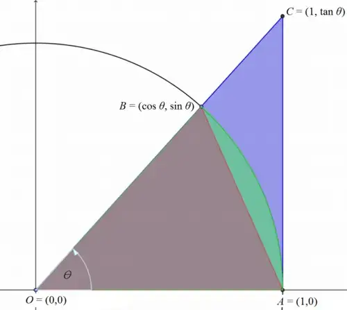

Before I go into this, there is absolutely nothing wrong with using degrees over radians. It will change what the definition of the derivative of the trigonometric functions are, but it won't change any of our math--it just introduces a tedious factor we always have to carry around.
I am going to use this geometric proof as a way to make sense of the limit above:
geometric proof link
There is only one part of the proof that will change if we decide to use degrees as opposed to radians and that is when we find the area of the sector subtended by $\theta$. When we use radians we get: $A_{AB} = \pi 1^2 * \frac{\theta}{2\pi} = \frac{\theta}{2}$--just as they found in the given proof. If however, we use degrees then we will get: $A_{AB} = \theta * \frac{\pi}{360}$. Now this changes their initial inequality which the rest of the proof relies on:
$$ \frac{1}{2}\sin(\theta) \leq \frac{\pi \theta}{360} \leq \frac{1}{2}\tan(\theta) $$
(the others don't change because the sine and tangents equal the same thing regardless of whether or not we use radians or degrees--with a proper, trigonometric definition of each, of course).
We still proceed in the same way (I'm going to be less formal and not worry about the absolute values--although we should technically). We divide everything by $\sin(\theta)$ which since I'm only worrying about the first quadrant won't change the directions of the inequalities:
$$ \frac{1}{2} \leq \frac{\pi \theta}{360 \sin(\theta)} \leq \frac{1}{2\cos(\theta)}\\ \frac{360}{2\pi} \leq \frac{\theta}{\sin(\theta)} \leq \frac{360}{2\pi \cos(\theta)} \\ \frac{\pi}{180} \geq \frac{\sin(\theta)}{\theta} \geq \frac{\pi}{180}\cos(\theta) $$
When we plug in $\theta = 0$ (whether radians or degrees) we get $\cos(0) = 1$ and thus we use the squeeze theorem to show that:
$$ \frac{\pi}{180} \leq \lim_{\theta \rightarrow 0} \frac{\sin(\theta)}{\theta} \leq \frac{\pi}{180} $$
Therefore, if we use degrees, then:
$$ \lim_{\theta \rightarrow 0} \frac{\sin(\theta)}{\theta} = \frac{\pi}{180} $$

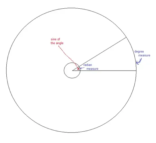

Try thinking of both degrees and radians as measures of arc length, where the radii differ between the two measurements. enter image description here Notice how $\sin \theta < \theta < A$ where $$ \theta: \text{the angle measured in radians}\\ A:\text{the angle measured in degrees} $$ In fact, $A = \frac{180}{\pi}\theta\approx 57.3\theta$ So the angle measured in degrees is always at least as large as 57.3 times the sine of the angle, no matter how small (i.e. close to zero) they become.

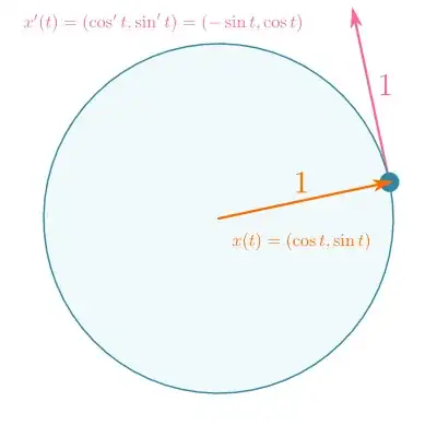

For convenience, let's measure time in seconds and distance in meters, so the unit circle has a radius of one meter.
Look at a point moving around the unit circle along the path $x(t) = (\cos t, \sin t)$. The usual trig functions are scaled so that the point will make a full circle every $2\pi$ seconds, which means it's moving at a speed of $1$ meter per second. In other words, the point's velocity $x'(t)$ is a unit vector.
Position and velocity for the usual trig functions.
Knowing this, it's not hard to figure out that $x'(t)$ is just $x(t)$ rotated a quarter turn counterclockwise. Now we have two ways of figuring out $x'(t)$: by taking the derivatives of the components of $x(t)$, and by rotating $x(t)$ a quarter turn counterclockwise. The fact that those two descriptions give you the same vector $x'(t)$ is precisely the fact that $$(\cos' t, \sin' t) = (-\sin t, \cos t).$$

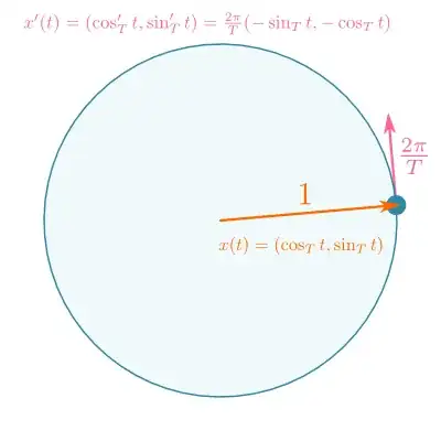

Now, what if we rescaled our trig functions so that the point made a full circle every $T$ seconds instead of every $2\pi$ seconds? Let's call the rescaled trig functions $\cos_T$ and $\sin_T$. When $T = 360$, we get the trig functions for angles measured in degrees.
Since the point is making a full circle every $T$ seconds, it's moving at a speed of $\tfrac{2\pi}{T}$ meters per second.
Position and velocity for time-rescaled trig functions.
You can calculate the derivatives of the rescaled trig functions using the same reasoning as before, and you get $$(\cos_T' t, \sin_T' t) = \tfrac{2\pi}{T}(-\sin_T t, \cos_T t).$$ So this is why setting $T = 2\pi$ gives derivatives with no extra factors: it's the scaling that makes $x(t) = (\cos_T t, \sin_T t)$ a unit-speed path.

Simply put: Because a radian is defined as the unit of measurement that makes $\sin(dx)\approx dx$.
As you have realized, for any unit of measurement you define as the basis of $\sin$, you'll have $\sin(dx)\approx \alpha\ dx$ for some $\alpha$. There is a specific unit of measurement for which $\alpha=1$. Call this unit a radian, and you're done.
Well, not really done because there are a lot of connections you still need to prove. But that's a basic idea that underlies much of math: You can define things however you like, but you can only define each once. If you want several different things to be true about a concept, you have to take one as the definition and prove the rest.
