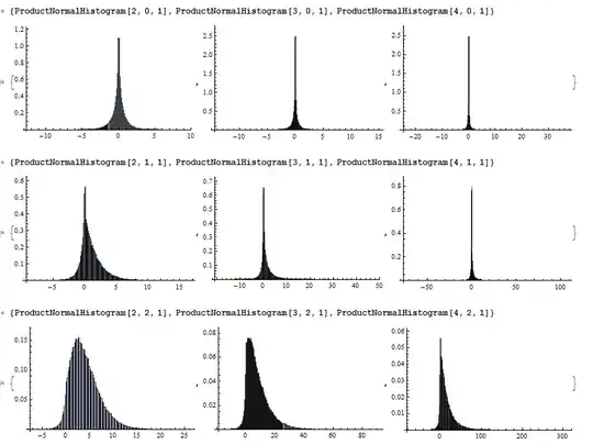

Let $X_k = Z_1 Z_2 \cdots Z_k$, where $Z_i$ are iid normal r.v. with mean $\mu$ and variance $\sigma^2$. The precise density would be hard to come by, but moments are easy to compute: $$ \mathbb{E}(X_k^r) = \mathbb{E}(Z_1^r) \mathbb{E}(Z_2^r) \cdots \mathbb{E}(Z_k^r) = \left(m_r(Z)\right)^k $$
Here is some simulation in Mathematica:
ProductNormalHistogram[k_Integer?Positive, \[Mu]_, \[Sigma]_] :=
Block[{x},
Histogram[
RandomVariate[
TransformedDistribution[Array[x, k, 1, Times],
Array[x, k] \[Distributed]
ProductDistribution[{NormalDistribution[\[Mu], \[Sigma]
], k}]], 10^5], Automatic, "PDF", ImageSize -> 250]]
For the case of $\mu=0$ and $\sigma = 1$, look-up product-normal distribution for some analytic results.

This would probably take me about a week, not being a good mathematician - but I will do it! For now, could you tell me approximately what shape the result would have? – Marcus Johnson Apr 19 '12 at 15:15
The result would leave you with a $\int\int\underbrace{\cdots}\int$ after changing the order of integration using Fubini...there would be $k$ integrals I guess. – Apr 19 '12 at 15:22
Oh, I meant the visual shape of the resulting pdf when plotted. :-) – Marcus Johnson Apr 19 '12 at 15:24
