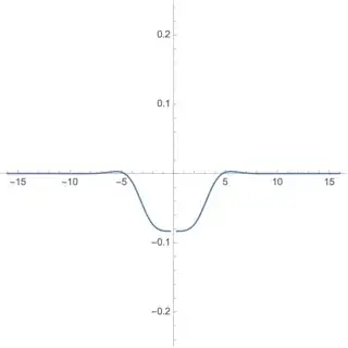

Here is a plot I made with Mathematica using the command
Plot[Evaluate[Sum[k*Exp[x*k]*Cos[x*k], {k, 1, Infinity}]], {x, -16, 16}, PlotRange -> {-.25, .25}, AspectRatio -> 1]
Notice how it approaches $-1/12\approx-0.08333$ as $x$ approaches $0$.

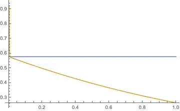

Thus \begin{align} \zeta(-s) &= \lim_{\varepsilon \rightarrow 0^+} \lim_{m \rightarrow \infty} \sum_{n=1}^m n^s f(s, n \varepsilon) \\ &\overset{\star}{=} \lim_{m \rightarrow \infty} \lim_{\varepsilon \rightarrow 0^+} \sum_{n=1}^m n^s f(s, n \varepsilon) \\ &= \lim_{m \rightarrow \infty} \sum_{n=1}^m n^s f(s, 0) \\ &= \lim_{m \rightarrow \infty} \sum_{n=1}^m n^s \\ &= \sum_{n=1}^\infty n^s \end{align}

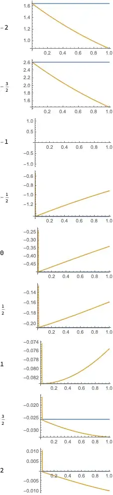

where the star indicates the non-rigorous step of exchanging limits. In fact, this regulator seems to work for all $s \neq -1$ (see some plots for $s < -1$ below). Hence we can also regularize the harmonic series as follows: \begin{align} \gamma &= \frac{1}{2} \lim_{\varepsilon \rightarrow 0^+} (\zeta(1+\varepsilon) + \zeta(1-\varepsilon)) \\ &= \frac{1}{2} \lim_{\varepsilon \rightarrow 0^+} \left(\lim_{m \rightarrow \infty} \sum_{n=1}^m n^{-1-\varepsilon} f(-1-\varepsilon, n \varepsilon) + \lim_{m \rightarrow \infty} \sum_{n=1}^m n^{-1+\varepsilon} f(-1+\varepsilon, n \varepsilon) \right) \\ &= \frac{1}{2} \lim_{\varepsilon \rightarrow 0^+} \lim_{m \rightarrow \infty} \left(\sum_{n=1}^m n^{-1-\varepsilon} f(-1-\varepsilon, n \varepsilon) + \sum_{n=1}^m n^{-1+\varepsilon} f(-1+\varepsilon, n \varepsilon) \right) \\ &\overset{\star}{=} \frac{1}{2} \lim_{m \rightarrow \infty} \lim_{\varepsilon \rightarrow 0^+} \left(\sum_{n=1}^m n^{-1-\varepsilon} f(-1-\varepsilon, n \varepsilon) + \sum_{n=1}^m n^{-1+\varepsilon} f(-1+\varepsilon, n \varepsilon) \right) \\ &= \frac{1}{2} \lim_{m \rightarrow \infty} \left(\sum_{n=1}^m n^{-1} f(-1, 0) + \sum_{n=1}^m n^{-1} f(-1, 0) \right) \\ &= \frac{1}{2} \lim_{m \rightarrow \infty} \left(\sum_{n=1}^m n^{-1} + \sum_{n=1}^m n^{-1} \right) \\ &= \lim_{m \rightarrow \infty} \sum_{n=1}^m n^{-1} \\ &= \sum_{n=1}^\infty n^{-1} \\ \end{align}
Here is the Mathematica code and its plots:
f[s_, x_] := Exp[-x] (1 + a x)
g[s_, t_] :=
 Evaluate@Simplify[
   f[s, t] /. Solve[Integrate[x^s f[s, x], {x, 0, Infinity}] == 0, a],
    Assumptions -> Re[s] > -1]
g[s, t]
Table[{s,
    Plot[{Zeta[-s],
      Sum[n^s g[s, n \[Epsilon]], {n, 1, 1000}]}, {\[Epsilon], 0, 1},
     Evaluated -> True]}, {s, -4, 4, 1/2}] // TableForm // Quiet
Plot[{EulerGamma,
  Sum[(n^(-1 + \[Epsilon]) g[-1 + \[Epsilon], n \[Epsilon]] +
    n^(-1 - \[Epsilon]) g[-1 - \[Epsilon], n \[Epsilon]])/
   2, {n, 1, 1000}]}, {\[Epsilon], 0, 1}, Evaluated -> True]

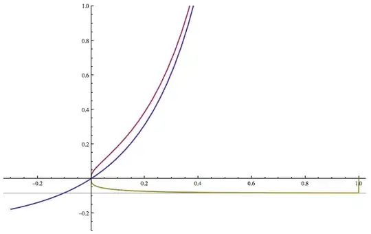

The picture shows the two functions $\dfrac{z}{(z-1)^2}$ and $\dfrac{1}{\log(z)^2}$, as well as their difference (blue, red, yellow). While the functions themselves clearly have a pole at $z=1$, their difference converges against
$$-\frac{1}{1!\,2!\,3!}=-\frac{1}{12}=-0.08{\dot 3}.$$

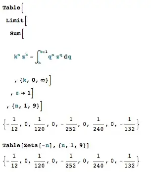

And here's the Mathematica calculation for higher $n$, as well as the corresponding values of the Zeta function (which match)
