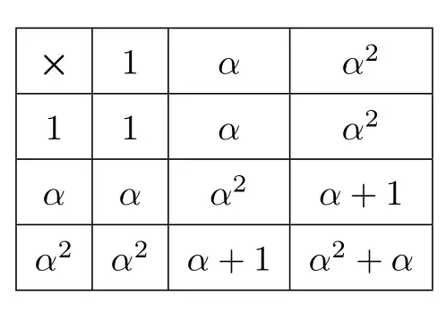

Using repeatedly the relation $\,\alpha^3=\alpha+1$, knowing a basis of $\mathbf Z_2[\alpha]$ over $\mathbf Z_2$ is $\{1,\alpha,\alpha^2\}$ we have the following table of multiplication:
Bernard
  • 179,256
  • Surely this table is incomplete? Where are $\alpha^2+1$ and $\alpha^2+\alpha + 1$? – Dilip Sarwate Jun 03 '15 at 00:49
  • I didn't show all the elements of $\mathbf F_{27}$, I produced a table that shows how elements of a basis multiply. You can expect only $9$ results (at most). The rest is obtained by linearity. – Bernard Jun 03 '15 at 00:58
