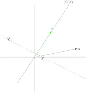

A least squares solution is not the shadow you refer to in the shining light analogy. This shadow is the orthogonal projection of $b$ onto the column space of $A$, and it is unique. Call this projection $p$. A least squares solution of $Ax = b$ is a vector $x$ such that $Ax = p$. The vector $x$ need not be unique.
Consider the matrix
$$A = \begin{bmatrix} 4 &8 \\ 6 &12 \end{bmatrix}$$ and the vector
$$b = \begin{bmatrix} 5 \\ 1 \end{bmatrix} $$
which is not in $C(A) = \textrm{span} \left( \begin{bmatrix} 4 \\ 6 \end{bmatrix} \right)$. The orthogonal projection of $b$ onto $C(A)$ is given by
$$ p = \frac{\begin{bmatrix} 4 \\ 6 \end{bmatrix} \cdot \begin{bmatrix} 5 \\ 1 \end{bmatrix}}{\begin{bmatrix} 4 \\ 6 \end{bmatrix} \cdot \begin{bmatrix} 4 \\ 6 \end{bmatrix}} \begin{bmatrix} 4 \\ 6 \end{bmatrix} = \begin{bmatrix} 2 \\ 3 \end{bmatrix}$$
$$Ax = p$$
This system has infinitely many solutions. The solution set is
$$x = \left\{ t \begin{bmatrix} -2 \\ 1 \end{bmatrix} + \begin{bmatrix} \frac{1}{2} \\ 0 \end{bmatrix}, t \in \mathbb{R} \right\} $$
Therefore, both $x_1 = \begin{bmatrix} \frac{1}{2} \\ 0 \end{bmatrix}$ and $x_2 = \begin{bmatrix} -\frac{7}{2} \\ 2 \end{bmatrix}$, for instance, are least squares solutions, because both $Ax_1 = p$ and $Ax_2 = p$. But neither of these solutions is the "shadow" you refer to in the shining light analogy. Rather, $p$ is the shadow, and $x_1$ and $x_2$ are simply vectors you could multiply $A$ by to get $p$.
