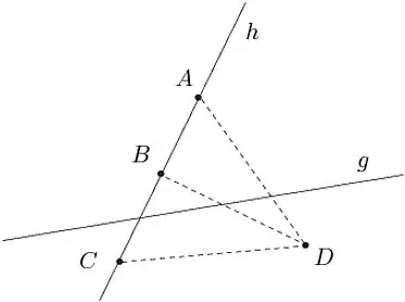

I am looking for a program to create images of very simple situations, e.g. this. I have already tried Geogebra but I am not quite satisfied with the result. I want my images to look as if they were taken from some (geometry) book; this is what I mean:
This was taken from my last year's geometry lecture notes. I feel like everyone is using the same program to create such images (because they all look the same).
Does anyone know what program I could use in order to create such images? I'm sure I could succeed with both MS Paint and Adobe Photoshop, but I'm looking for some program made to create such images. I hope this is the right place to ask for this and thanks for any help in advance.

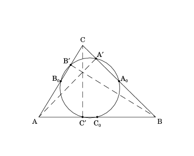

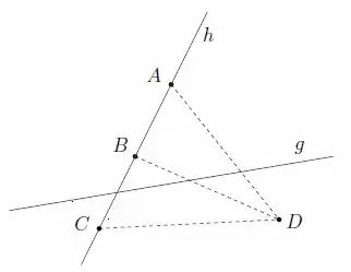

I use Omnigraffle for the Mac. It is by far the easiest figure-maker for mathematics and is LaTeX friendly. Simply drag and drop predefined shapes (including points, lines, polygons, etc.) within Omigraffle, adjust them as needed for size, opacity, color, etc., use LaTeXIt to add labels or equations, save, then export to pdf or eps. I created the following faithful reproduction of your image by sight in 45 seconds.
user02138
  • 17,314

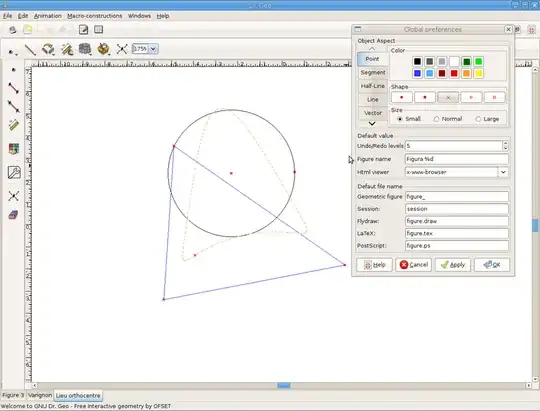

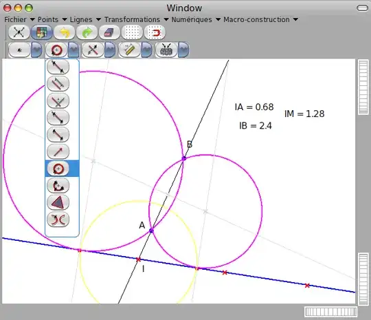

You might also try out DrGeo which is a interactive geometry program.
Screenshot 1 Screenshot 2
Screenshot 1 source: http://screenshots.debian.net/screenshots/d/drgeo/2090_large.png
Screenshot 2 source: http://blog.ofset.org/public/drgeo/DrGeoII-2cercles.png

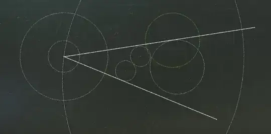

Crealesson feels like a blackboard drawings as multi-board something like power-point. produces small videos without any additional software. enter image description here
