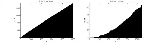

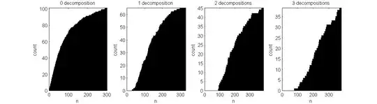

Below you'll find some plots, where I summed up $4$ squares with $\max a_j=300$ and $4$ cubes with $\max a_j=200$.
They show a quite different behaviour, concerning their curvature, but I'm not sure if this is an artifact of the sample I have taken.
EDIT: The linear appearance of the lower left cube-plot might be related to the fact that even if $a_j=a_k$ is allowed (Waring's problem) $9$ cubes are needed to represent all numbers. So does the curvature related to the number of $p$ powers I add up?
