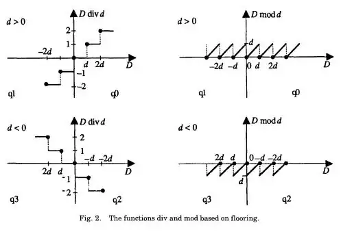

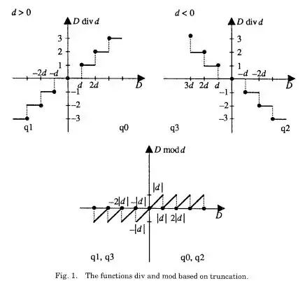

A web search will turn up further discussion of such conventions in many places, e.g. on Wikipedia and D. Leijen, Division and Modulus for Computer Scientists., and R. Boute, The Euclidean Definition of the Functions div and mod, which includes the following figures
