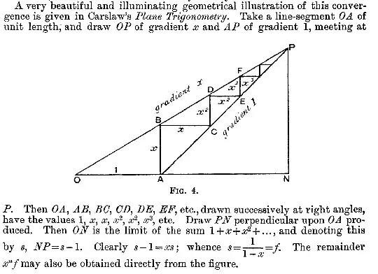

Here's an extremely nice picture illustrating the geometric series and making it geometrically clear how it converges when $x<1$.
$s-1=xs$ follows from $PN/ON=BA/OA$ which follows from the fact that $\triangle OAB$ is similar to $\triangle ONP$.

4Great added bonus for the (unfamiliar to me) proof for the sum :) – Nathaniel Bubis May 15 '15 at 04:11
@nbubis Right, I only knew how to make the geometric series intuitive and visual for $x=1/2$, but this allows one to do it for all $x\in(0,1)$. – Gregory Grant May 15 '15 at 17:47
1@AlecTeal It's this one: http://www.amazon.com/Plane-Trigonometry-H-S-Carslaw/dp/B00BGGHADM/ref=tmm_hrd_title_0 – Gregory Grant Jun 07 '15 at 12:51
@AlecTeal I realized you probably meant what book is the one that is referencing Carslaw. I'm not sure, I found it here: http://imgkid.com/geometric-sequences-formulas.shtml And I can't seem to find any other reference to it. It's pretty obscure I guess. – Gregory Grant Jun 07 '15 at 14:05
@Gregory Grant: Really beautiful. And incidentally also "makes" analysis, not just geometry. – Ataulfo Jun 30 '15 at 12:38
2@AlecTeal The image is not from a book; it comes from page 245 of this paper: W.J. Dobbs, "The Introduction to Infinite Series", The Mathematical Gazette 9, no. 135 (May 1918), pp. 242--246, DOI: 10.2307/3605310. – Senex Feb 14 '19 at 14:18

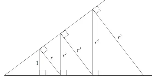

Here is a geometric figure illustrating the geometric progression $1,r,r^2,r^3,r^4,r^5,\ldots$:

5Now that's a good picture! We don't have to worry about whether people were thinking about $8$-dimensional cubes, however long ago the terminology came about. – pjs36 May 14 '15 at 14:26
3So I guess we pick $r$ and draw the edge you have labelled as $r$. Then the hypotenuse of the resulting triangle is $r^2$? Can you please post a proof of that? Does this depend on the length of the other two edges of the first right triangle (the leftmost one with one leg labelled $1$). You haven't labelled them and they aren't uniquely determined by one leg being length one. Thank you. – Gregory Grant May 14 '15 at 14:37
6@GregoryGrant The triangles are all similar, that uniquely determines everything. The second triangle from the bottom is drawn first and then the first triangle is drawn similar to the second and so on... – Asvin May 14 '15 at 14:47
1@GregoryGrant Its pretty easy to proof, you can prove it using the properties of similar triangles. Just do an internet search and you will definitely find a very neat proof. ;) – dark32 May 14 '15 at 15:24
1Yes I proved it, the conceptual leap was to realize the second triangle from the bottom is drawn first. Then it's easy to show that all right triangles in this figure are similar which follows from Euclid's most basic propositions on angles and parallel lines. – Gregory Grant May 14 '15 at 15:46
5Is there any useful information that can be read off this figure? What would it look like for the interesting case when $r < 1$? – Rob Arthan May 14 '15 at 19:16
9@RobArthan If $r<1$, you draw the figure approaching the vertex rather than going away from it. – Mario Carneiro May 15 '15 at 09:13
1Beautiful pictorial illustration of the geometric progression when $r\gt1$. However this is not an answer to the question about the provenance of the term "geometric". – Ataulfo Jun 30 '15 at 03:26
3@Ataulfo I've since become aware of this paragraph from the Oxford English Dictionary: "Arithmetical progression, proportion, ratio, etc. ... relate to differences instead of quotients. The term geometrical points to the fact that problems involving multiplication were originally dealt with by geometry and not by arithmetic." That's the best answer I have for the first part of the question. – David K Jun 30 '15 at 04:46
