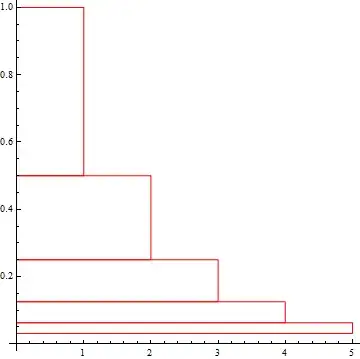

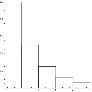

Split the same region to infinitely many rectangles in two different ways. The red way gives the area as the sum in question. The black way is something even easier to calculate.
