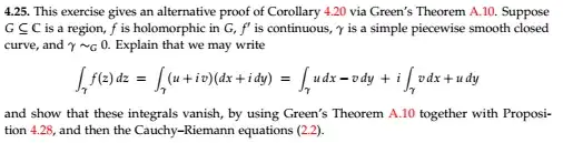

That's Green's Theorem can be used to prove Cauchy's Theorem or a corollary of it, depending on your text, is in A First Course in Complex Analysis by Matthias Beck, Gerald Marchesi, Dennis Pixton, and Lucas Sabalka Exer 4.25
Note that that $f'$ assumption is superfluous because $f$ is holomorphic, but this is not proven until Ch5.

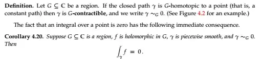

Appendix
Green's Theorem is stated as:
Cor 4.20 is a corollary of Cauchy's Thm 4.18 for the authors and is stated as:
Cauchy's Thm 4.18 is stated as:
The authors acknowledge that Cauchy's Theorem is sometimes designated to be the statement in Cor 4.20 instead of their Thm 4.18
