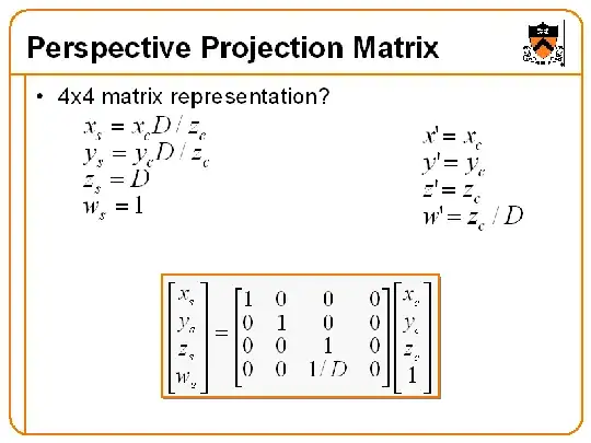

Could you explain why there are a lot of examples of perspective matrices with various values inside? For example I like this easy one:
http://www.cs.princeton.edu/courses/archive/fall99/cs426/lectures/view/img029.gif

The first example you quote has its geometrix effect already denoted in the upper left corner. You can think about this as two distinct steps. In the first step, the vector $(x,y,z)$ is divided by $z$. This means you're projecting your line of sight onto the plane $z=1$. Afterwards, everything is scaled by $D$ in the $x,y,z$ directions. So you have a plane of fixed depth somewhere in your image space. Which is of little use in case you want to do something like depth comparisons.

The "easy" one is the perspective divide in matrix form, which has to follow the "awful" one.
The "easy" matrix shows the right column starting with $x' = x_c$. x, y and z all have identity; only w is z/D. But with contradicting indices (s, c, slash) and an undefined D (for depth?) I don't see much sense in this matrix. The thing itself - divide by z - is important, of course.

But the division by z can't be coded in a matrix. This perspective divide is done afterwards. Maybe the "easy" matrix is for this step, but it seems overkill. The perspective divide is
$x_{ndc} = x_{clip} / w_{clip}$
and same for y and z. No need for a matrix, only the z value saved into the w coordinate by the perspective matrix. In OpenGl the variable gl_FragCoord holds the current x, y and z values ie. NDC scaled to window size (for x and y) or depth range (for x). The 4th coordinate contains 1/w. The "easy" matrix would make more sense with a $w_s = 1 / z_c$. Dividing $w_c$ by itself would be just another way to say "1".
So the "google" matrix does the perspective projection of a geometric frustum into a normalized cube, but minus the final division, which is only prepared.
It is not a question of converting, but of doing the second first and then replacing the first with a simple perspective divide.
