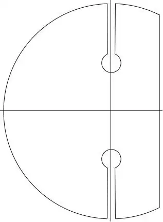

We may derive the integral above by considering the computation of the inverse Laplace transform of $(1+s^2)^{-1/2}$. Consider
$$\oint_C dz \frac{e^{z t}}{\sqrt{1+z^2}} $$
where $C$ is defined by the following contour:
where the Bromwich contour is deformed to avoid the branch points at $\pm i$. In the limit of the radius of the outer arcs goes to infinity and the radius of the smaller circles about the branch points goes to zero, we have that
$$\int_{c-i \infty}^{c+i \infty} ds \frac{e^{s t}}{\sqrt{1+s^2}} + i \int_{\infty}^1 dy \frac{e^{i y t}}{\sqrt[+]{1-y^2}} + i \int_1^{\infty} dy \frac{e^{i y t}}{\sqrt[-]{1-y^2}} \\ - i \int_{\infty}^1 dy \frac{e^{-i y t}}{\sqrt[+]{1-y^2}} - i \int_1^{\infty} dy \frac{e^{-i y t}}{\sqrt[-]{1-y^2}} $$
where $\sqrt[+]{1-y^2} = i \sqrt{y^2-1}$ and $\sqrt[-]{1-y^2} = -i \sqrt{y^2-1}$ represent the different branches of the square root. We thus have, by Cauchy's theorem, that the contour integral is zero so that the ILT is
