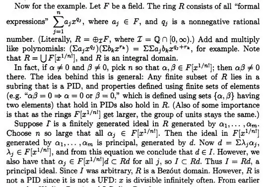

Common examples of non-PID Bezout domains are the rings of all algebraic integer or entire functions, e.g. this answer. For a simpler example one may consider the semigroup ring $\, F[x^{\Bbb Q_{\ge 0}}].\, $ Below is a sketch of this example from M. S. Osborne's Basic Homological Algebra, p. 92.
