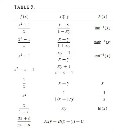

Such addition laws have indeed been studied. For example, see the interesting Monthly article by Sam Northshield, Associativity of the Secant Method, which I mentioned in an earlier post on Rudin's use of the secant method for approximating $\,\sqrt2.\,$
Below is a table of addition laws excerpted from the article. These group laws are essentially group laws on degenerate elliptic curves. For more on this viewpoint see Franz Lemmermeyer's Conics - a poor man's elliptic curves.
