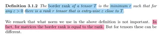

For completeness this is were I read this claim of the equivalence:
Link to the whole document (page 27):
http://people.csail.mit.edu/moitra/docs/bookex.pdf
