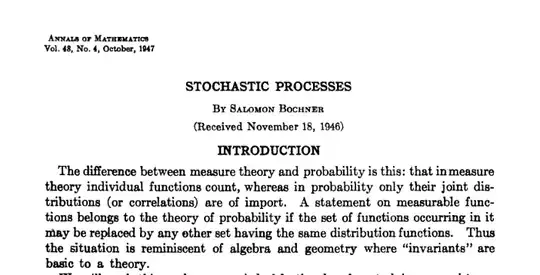

Salomon Bochner's words in the introduction to his article entitled 'Stochastic Processes' published in 1947 in volume 48 of the Annals of Matematics:
The link to full text.
