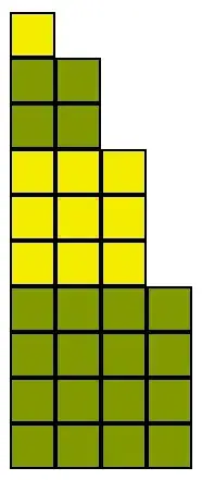

You want the number of squares in the following image:
If you assign three coordinates $(a,b,c)$ to each of the small squares. Where $a$ tells you the big square to which the small square belongs, $b$ gives you the horizontal position of the small square within the big square and $c$ gives you the vertical position of the small square within the big square, what you want to count is the number of triples $(a,b,c)$ with $n\geq a\geq b,c$. Separate into three to count:
There are $2\binom{n}{3}$ where all entries are different.
There are $3\binom{n}{2}$ where $2$ entries are equal and two different.
There are $n$ where all entries are equal.
The final answer is thus:
$2\binom{n}{3}+3\binom{n}{2}+n=\frac{2n(n-1)(n-2)}{6}+\frac{3n(n-1)}{2}+n=\frac{n(n+1)(2n+1)}{6}$
This method can be used to find the sum of the $n$'th powers, but you need to compute stirling coefficients and it can get messy. Although it should be straightforward to see how we can prove from here that the formula is always going to be a polynomial of degree $n+1$
