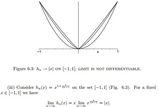

Take $h_n(x) = x^{1+ \frac{1}{2n-1}}$ on the set $[-1,1]$
Then if we take $\lim_{n \to \infty} h_n(x)$ shouldn't this converge to $x$
seeing as
$$\lim_{n \to \infty} h_n(x) = x \lim_{n \to \infty} x^{\frac{1}{2n-1}} = x?$$
book says this

The illustration of the curves $h_n(x)$ for several values of $n$ suggests that the author's argument is something similar to:
since $\forall n\in\mathbb{N}$ an odd root of a negative number $x$ is negative:
\begin{align} \sqrt[2n-1]{x}&=-\sqrt[2n-1]{|x|}, \end{align} then \begin{align} x\cdot (\sqrt[2n-1]{x})=-x\cdot(\sqrt[2n-1]{|x|})=|x|\cdot(\sqrt[2n-1]{|x|}). \end{align}
And then a limit is taken:
\begin{align} \lim_{n \to \infty}|x|\cdot(\sqrt[2n-1]{|x|})=|x|. \end{align}
And indeed, an illustration clearly shows that the curve is closer and closer to $|x|$ with bigger $n$, but can you spot a false step here?
What is missed here is that the limit of a sequence is something different from the sequence elements, which can sometimes have some properties that none of the items $h_n$ has.
The very basic assumption "the root is odd" is valid for any arbitrary big $n$, but it is not true when $n=\infty$. In other words, the $-1$ can "ecsape" any gravity of the odd root, except the infinite one.
