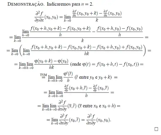

Another one ("TVM" stands for "mean value theorem"): enter image description here
Note that this second proof also shows that we only need that both partial derivatives exist, with only one of them being continuous. It is a stronger version.

    I know this is quite an old answer, but why is the second last equality true? It could be that $\overline{t}$ depends on $h$, since the function $\varphi$ depends on $h$. It's not clear to me why the limit of $\overline{t}$ when $h$ goes to $0$ should exist. – J. C. Mar 21 '20 at 15:25
