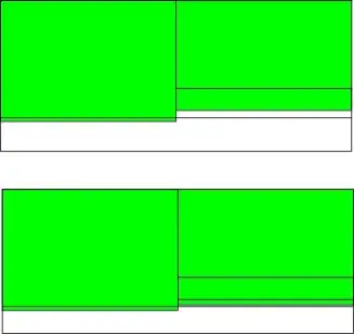

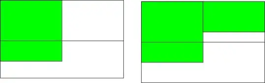

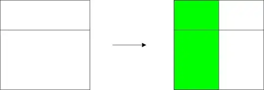

We start with the unit square (I marked the $1/3$ line), and add $1/2$:
We take $1/4$ and add $1/8$
We take $1/16$ and add $1/32$
One more

    You should really draw those figures to scale; it looks like you've proved that your sum is $2/3$... By the way, a nice geometric proof that $1/4 + 1/16 + 1/64 + \cdots = 1/3$ (which is equivalent to what you're proving) is the second figure on this page. –  Mar 06 '12 at 08:37
  • In the spirit of @Rahul's idea of summing $1/4+1/16+\cdots$ we can also divide the rectangle into four equal size congruent rectangles (halve both sides), then keep doing the same for the quadrant in top right. After countably infinitely many steps you have 3 rectangles of each size, and can combine them to form the three equal area regions. – Jyrki Lahtonen Mar 06 '12 at 10:32
  • @RahulNarain I zoomed in for a matter of visibility. – Pedro Mar 06 '12 at 17:47
