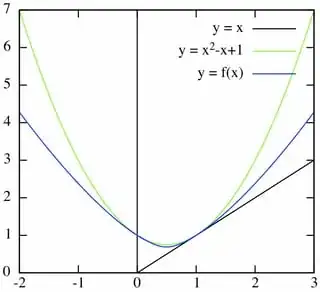

There are infinitely many solutions to $f(f(x))=x^2-x+1$ for $f\colon\mathbb{R}\to\mathbb{R}$ and, in fact, infinitely many differentiable solutions. However, there is only one continuously differentiable solution.

  1. $f(1)=1$
  2. $f$ is strictly increasing over $x\ge1/2$.
  3. $x\le f(x)\le g(x)$ for all $x$.
  4. $f(x)=f(1-x)$ for all $x$.
  5. $f^\prime(1)=1$.
The first property is noted in the question, and does not require continuity. If $f(1)=a$ then we have $f(a)=f(f(1))=g(1)=1$. So, $g(a)=f(f(a))=a$ and, the only fixed point of $g$ is $a=1$.
Next, if $a\not=b\in[1/2,\infty)$ and $f(a)=f(b)$ then, $g(a)=f(f(a))=f(f(b))=g(b)$, so $a=b$. So, $f$ is one-to-one and continuous on this range, implying that it is either strictly increasing or strictly decreasing. We can rule out the decreasing case - as noted in the question, $f(x)\ge3/4$ for $x\ge3/4$. If $f$ was decreasing over $x\ge1/2$ then, as it is bounded below, it would be bounded. So, $g(x)=f(f(x))$ would be bounded, which it isn't. This proves the second statement.
Over $x > 1$ we have $f(x)\not=x$ (otherwise, $x$ would have to be a fixed point of $g$). Then, we either have $f(x) > x$ or $f(x) < x$ for all such $x$. We can rule out the second case, as it would imply that $g(x)=f(f(x))<x$ which is false. By a similar argument, $f(x) > x$ for all $x < 1$. Also, if $f(x) > g(x)$ for any $x$, then we would have $g(x)=f(f(x))\ge f(x) > g(x)$, which is a contradiction. This proves statement 3.
As noted in the question, $f(x)=f(1-x)$ or $f(x)=1-f(1-x)$ for all $x$. In particular, for $x < 1/2$, we can use the inequality $f(1-x) > f(1/2)\ge1/2$ to see that $f(1-x) > 1 - f(1-x)$. So, by continuity we either have $f(x)=f(1-x)$ for all $x\le 1/2$ or $f(x)=1-f(1-x)$ for all such $x$. We can rule out the second case, as it implies that $f(x) < 1/2$ for all $x < 1/2$, which would give the contradiction $g(x)=f(f(x))<1/2$. We have proved statement 4 for all $x\le 1/2$. For $x\ge1/2$ we can replace $x$ by $1-x$ to prove the statement.
Finally, for statement (4) we can apply (3) to get, $$ \frac{(1+h)-1}{h}\le\frac{f(1+h)-f(1)}{h}\le \frac{g(1+h)-1}{h} $$ for all $h>0$. Both sides of this inequality tend to $1$ as $h\to0$. The same argument applies for $h < 0$, except that the inequalities are the other way round. So, $f^\prime(1)=1$.

Methods due to Jean Ecalle in the 1970's give the following: there is a real analytic solution for $x > 1.$ What makes it so hard is that the derivative at the fixpoint is exactly $1.$
There is also a real analytic solution for $0< x < 1.$
Where the two meet, the resulting joined function is continuous, differentiable, $C^1$ and actually $C^\infty,$ of Gevrey class.
The solution for $x > 1$ can be reflected across for $x < 0.$ Thus the curve is not $C^\omega$ at $0,$ either.
