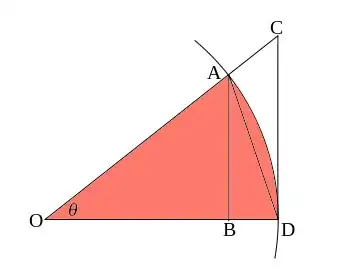

Consider the following diagram:
The chord $AC$ is shorter than the red arc which is again (by visual intuition) shorter than the path $ABC$. This means that $$2s<arc<2d$$ Note that $|OD|=\sqrt{1-s^2}$ by the Pythagorean theorem. Now, since $\Delta ABD$ and $\Delta OAD$ are similar, we see that $$\frac sd=\frac{\sqrt{1-s^2}}1$$ so dividing the chord length $2s$ by $2s,arc$ and $2d$ considering inequalities from before we then have $$1>\frac{2s}{arc}>\frac{2s}{2d}=\sqrt{1-s^2}$$ and it follows that $$\frac{2s}{arc}=\frac{chord}{arc}\longrightarrow 1\quad\text{when}\quad chord,arc\longrightarrow 0$$
Problem: Since the inequality $arc<2d$ was based solely on intuition, I could just as well have claimed that $\frac{chord}{arc}\longrightarrow 1$ by intuition in the first place anyway. Perhaps my intution about the inequality is stronger than my intuition about the limit, but that does not make it more rigorous ...
Question: How can we define the notion of arc length and based on that show rigorously that $arc<2d$?

One way to define the arc length of a curve $\gamma:[a,b]\to\mathbb R^2$ is by considering partitions of $[a,b]$, as in Riemann integration (read this Wikipedia article first): if $P(x,t)$ is a tagged partition of $[a,b]$, then $L_\gamma(P)$, the length of $\gamma$ with respect to the partition $P$, is $\sum_{i=1}^{n-1}|\gamma(t_i)-\gamma(t_{i-1})|$.
Definition: If $\underset{P}{\lim \sup} L_\gamma(P)$ exists, then $L_\gamma = \underset{P}{\lim \sup} L_\gamma(P)$ is the length of the curve.
Now consider the portion of the red arc between the point $A$ and the line $BD$. Using the above definition, we can see that the length of this arc lies between $AD$ and $AB$: if $\gamma(t_{i-1})$ and $\gamma(t_i)$ are points on the curve, we can project them perpendicular to $AD$ onto the points $r_{i-1}$ and $r_i$ on $AD$, and $s_{i-1}$ and $s_i$ on $AB$. And then we have $|r_i-r_{i-1}| < |\gamma(t_i)-\gamma(t_{i-1})| < |s_i-s_{i-1}|$, by simple geometry.
Therefore $L_{AD}(P) < L_\gamma(P) < L_{AB}(P)$ (taking some liberties with the notation). And in the limit we get:
$$\underset{P}{\lim \sup}L_{AD} \le \underset{P}{\lim \sup}L_\gamma(P) \le \underset{P}{\lim \sup}L_{AB}$$
In other words: $$AD \le L_\gamma\le AB$$
To show strict inequality would not be too difficult $-$ for instance, if we are more than halfway to the line $BD$, then there is a constant $\mu < 1$ such that $|\gamma(t_i)-\gamma(t_{i-1})| < \mu|s_i-s_{i-1}|$. This would give $L_\gamma(P) < \frac12(1+\mu)L_{AB}(P)$, so $L_\gamma \le \frac12(1+\mu)AB$.

    I really like this $\lim\sup$-approach! This is very much what I had in mind. Since all we have defined beforehand is the length of a straight line segment, there seems to be no other way to talk about lengths than to consider approximations by line segments. But this way of doing it seems very general and avoids unnecessary machinery from differential geometry. – String Feb 04 '15 at 21:05
  • For the current purpose, I do not need strict inequalities anyway. I am not very familiar with axiomatic systems, but we must be in some setting of Euclidean geometry assuming the Pythagorean theorem for triangles and the principle that a straight line segment defines the shortest path between two points. Your suggested definition seems to me to be the closest I can get to making this argument sound without simply assuming $\frac{chord}{arc}\rightarrow 1$ as an axiom - though your definition is still slightly suggestive of that idea ... – String Feb 05 '15 at 09:27

another method to deduce derivatives of trig functions
(Not an answer to the original question, since it does not involve arc length. But the original question shows that the "arc length" approach may not be so intuitively obvious. Thus, my preference for an "area" method.) (Found in many textbooks, and, for example, http://en.wikipedia.org/wiki/Proofs_of_trigonometric_identities#Inequalities).

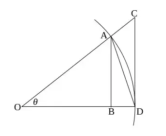

We consider angle $\theta > 0$, but close to zero. Similar diagrams may be made for $\theta<0$. Let angle $\theta$ be given. Draw a unit circle with center $O$. Let radii $OD$ and $OA$ of that circle be such that $\angle AOD = \theta$.
diagram
Let point $B$ be on segment $OD$ so that $AB$ is perpendicular to $OD$. Let $C$ be on ray $OA$ such that $DC$ is perpendicular to $OD$. Thus $DC$ is tangent to the circle. According to trigonometry, $|OB| = \cos \theta$, $|AB| = \sin \theta$, $|CD| = \tan \theta$.
Now, when $\theta \to 0+$, point $B$ approaches point $D$, so we get a cosine limit $$ \lim_{\theta\to 0+}\cos\theta = 1 $$
sector
Now consider the sector of the circle between the two radii $OA$ and $OD$. This sector is the fraction $\theta/(2\pi)$ of the whole circle. The whole circle has area $\pi$, so this sector has area $\pi \cdot \theta/(2\pi) = \theta/2$.
The triangle $OAD$ has area $|OD|\cdot|BA|/2 = (\sin\theta) / 2$. This triangle is contained in the sector, so the area of the triangle is less than the area of the sector. So we get inequality $$ \sin\theta < \theta $$
The triangle $ODC$ has area $|OD|\cdot|CD|/2 = (\tan \theta) / 2$. This triangle contains the sector, so we get inequality $$ \theta < \tan \theta = \frac{\sin\theta}{\cos\theta} $$
Now, from these inequalities, we get $$ \cos\theta < \frac{\sin\theta}{\theta} < 1 $$ Using the cosine limit above, we have a sine limit: $$ \lim_{\theta \to 0+}\frac{\sin\theta}{\theta} = 1 $$
Now we need another cosine limit. $$ \frac{1-\cos\theta}{\theta^2} = \frac{1-\cos^2\theta}{\theta^2(1+\cos\theta)} =\frac{\sin^2\theta}{\theta^2(1+\cos\theta))} = \frac{\sin\theta}{\theta} \cdot \frac{\sin\theta}{\theta}\cdot \frac{1}{1+\cos\theta} \to \frac{1}{2} $$ as $\theta \to 0$.
From these we can prove the formulas for the derivatives of the trig functions.

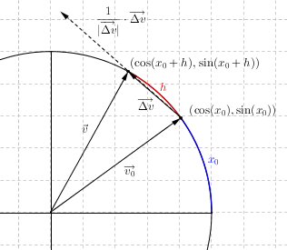

This is not actually an answer, but some details that I left out in the original post to avoid it being too lengthy:
Once I have sorted out the problem of defining arc lengths and proven that $\frac{chord}{arc}\longrightarrow 1$ as $chord,arc$ tends to zero, my proof of the derivatives of $\sin(x)$ and $\cos(x)$ goes as follows:
For some fixed $x_0\in\mathbb R$ and variable $h\in\mathbb R$ define $$\vec v_0=\begin{pmatrix}\cos(x_0)\\\sin(x_0)\end{pmatrix}\quad\text{and}\quad\vec v=\begin{pmatrix}\cos(x_0+h)\\\sin(x_0+h)\end{pmatrix}$$ Then define the chord vector $\overrightarrow{\Delta v}=\vec v-\vec v_0$ and consider the following: $$\begin{pmatrix}\frac{\cos(x_0+h)-\cos(x_0)}h\\\frac{\sin(x_0+h)-\sin(x_0)}h\end{pmatrix}=\frac 1h\cdot\overrightarrow{\Delta v}=\underbrace{\frac{|\overrightarrow{\Delta v}|}{h}}_{chord/arc}\cdot\overbrace{\frac 1{|\overrightarrow{\Delta v}|}\cdot\overrightarrow{\Delta v}}^{\text{secant unit vector}}$$ Now, the first fraction is essentially $\frac{chord}{arc}$ tending to $1$ as $arc=h$ tends to zero. The rest is a secant unit vector through the endpoints of $\vec v$ and $\vec v_0$ respectively, so as $h$ tends to zero this tends to the tangent unit vector $$\widehat{\vec v_0}=\begin{pmatrix}-\sin(x_0)\\\cos(x_0)\end{pmatrix}$$ So we have shown that $$\begin{pmatrix}\frac{\cos(x_0+h)-\cos(x_0)}h\\\frac{\sin(x_0+h)-\sin(x_0)}h\end{pmatrix}\longrightarrow\begin{pmatrix}-\sin(x_0)\\\cos(x_0)\end{pmatrix}$$ as $h$ tends to zero. Thus $\cos'(x_0)=-\sin(x_0)$ and $\sin'(x_0)=\cos(x_0)$.
