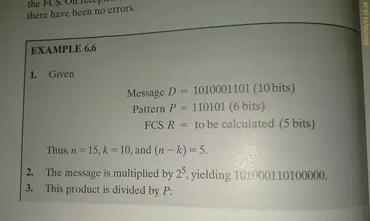

PS. I might get a little confused here. In the book I am being explained to first find the M, P, and state that FCS R to be calculated. Then I am being asked to find N, K, and N-K which I have done but I dont understand where the numbers coming from so I improvised and got:
n = 13
k = 8
n – k = 5

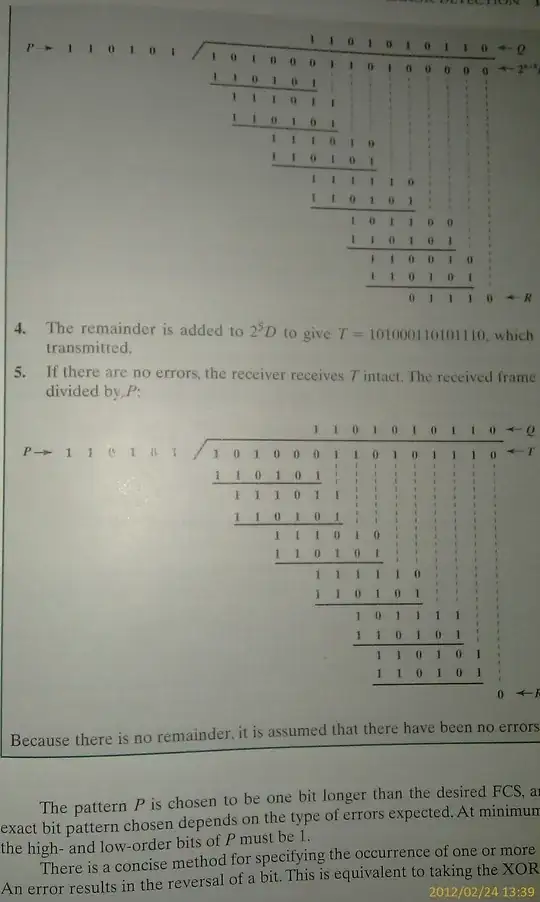

Then I am asked to "the message is multiplied by 2^5" so my message should be: 1110001100000 (????)
And here I am stuck on first 3 steps.
This is what my book have about this topic which kind of confuses me.

Let us use $x$ as an unknown. When dealing with CRCs a common choice is to use $D$ (as in DELAY) as the unknown, but your textbook (IMHO unwisely) has denoted the message by $D$ in that example, so let's use $x$ here.

The degree of our CRC-polynomial is five, so we shall add five redundant bits to the message $M(x)$. These redundant (or check) bits are also a polynomial $$ R(x)=r_4x^4+r_3x^3+r_2x^2+r_1x+r_0, $$ but we don't know those bits $r_i,i=0,1,2,3,4,$ yet the task is to calculate them! One of the questions that you asked was: how do we know that there will exactly five check bits? The reason is that when we divide other polynomials by $P(x)$ the remainder of (long) division will have degree that is less than the degree of $P(x)$. So in this case it will have degree at most four (just like the polynomial $R(x)$ above), and polynomials of degree at most four are specified by five coefficients (like $r_i,i=0,1,2,3,4$). In other words, you always have $n-k=$ the length of $P$ minus $1$, here $n-k=6-1$. Given that the message is $k=8$ bits long, you get $n=k+(n-k)=8+(6-1)=13$ bits.
The idea in CRC-calculation is to first make room for those $n-k=5$ bits at the LSB-end of $M(x)$ by multiplying it with $x^5$. Then the rule for selecting the polynomial $R(x)$ is that the polynomial $$ M(x) x^{n-k}+R(x)=M(x)x^5+R(x) $$ must be divisible by the CRC-polynomial $P(x)$. So the polynomial $R(x)$ must be the negative of the remainder, when $M(x)x^5$ is divided by $P(x)$. Because modulo 2 we have that $-0=0$ and $-1=1$ we can forget about that 'negative'. Let's calculate! The product $R_0:=M(x)x^5=x^{12}+x^{11}+x^{10}+x^6+x^5$ is of degree twelve. In other words it has a total of $n=13$ coefficients. To compute the remainder of polynomial division we keep subtracting multiples of $P(x)$ from this polynomial as long as we can. Because $P(x)$ is of degree five, and the highest degree term of $R_0$ is $x^{12}$ we subtract from it (or add to it as it makes no difference!) the polynomial $x^7P(x)$. Here $7=12-5$ is chosen to make the highest degree terms both be of degree twelve. So we compute the first remainder $$ R_1:=R_0+x^7P(x)=(x^{12}+x^{11}+x^{10}+x^6+x^5)+x^7(x^5+x^4+x+1)=x^{10}+x^8+x^7+x^6+x^5. $$ Notice that we were a bit lucky in the sense that in addition to the degree twelve terms, also the degree eleven terms cancelled. This remainder is of degree ten, which is still too high. The polynomial $x^5P(x)$ is also of degree ten, so let's add that next: $$ R_2:=R_1+x^5P(x)=(x^{10}+x^8+x^7+x^6+x^5)+x^5(x^5+x^4+x+1)=x^9+x^8+x^7. $$ This is of degree $9>4$, so we continue $$ R_3:=R_2+x^4P(x)=(x^9+x^8+x^7)+x^4(x^5+x^4+x+1)=x^7+x^5+x^4. $$ Still too high degree... $$ R_4:=R_3+x^2P(x)=(x^7+x^5+x^4)+x^2(x^5+x^4+x+1)=x^6+x^5+x^4+x^3+x^2. $$ ...not there yet... $$ R_5:=R_4+x P(x)=(x^6+x^5+x^4+x^3+x^2)+x(x^5+x^4+x+1)=x^4+x^3+x. $$ Tadaa! This remainder is finally of degree less than that of $P(x)$, so we must stop. So we are done, and may set $R(x):=R_5 =x^4+x^3+x.$
As the finishig touch we first compute the sum $$ M(x)x^5+R(x)=x^{12}+x^{11}+x^{10}+x^6+x^5+x^4+x^3+x, $$ and then extract the coefficients of the terms $x^{12},x^{11},\ldots,x^2,x,x^0=1$ (in that order) to form get the final string of 13 bits $$ 11100011|11010. $$ Here the original message is the first 8 bits, and the CRC-check (or whatever you call it in your application) is the last five bits, i.e. $11010$.
