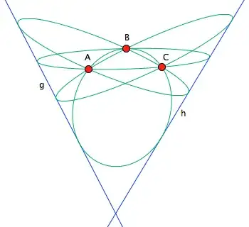

What's the most elegant way to find these four conics which pass through three given points $A,B,C$ and are tangent to two given lines $g,h$?
Figure
I have some algorithm to do this, but its core lies in finding roots of two distinct quartic equations, one for either touching point, and then pairing solutions numerically. The coefficients of the quartic equations are huge, both in term of space they need to write down and of how big the numbers get. I might add this approach as an answer eventually if nothing better turns up.
I hope someone finds a way to translate this problem into the intersection of two conics, in such a way that each point of intersection corresponds to one solution without any need to match things. But other elegant solution would be welcome as well.

8
The comment by Narasimham made me aware of a very elegant way of tackling this problem. The figure above can be interpreted as the orthogonal projection of a right cone whose axis lies in the plane. The cone intersects the plane in the two lines, $g$ and $h$. The points $A,B,C$ are in fact points on the cone, so they lie either above the plane or below the plane but are projected orthogonally into the plane. These three points in space define a plane, and that plane intersects the cone in a conic section. The orthogonal projection of that conic section is again a conic section, namely one of the four indicated in the figure. The four different solutions come from different choices about which of the points $A,B,C$ lie above the plane and which below. Since reflecting everything in the plane doesn't affect the resulting projected conic, one of the three points can be chosen arbitrarily, while the other two each allow for two possible choices, leading to $2^2=4$ generally distinct solutions.
So let's make this a bit more explicit. Using a suitable projective transformation defined by four points and their images, one can achieve a situation where the lines $g$ and $h$ intersect in the point $(0:0:1)$, the line $g$ intersects the line $AB$ in $(1:0:0)$ and the line $h$ intersects the line $AB$ in $(0:1:0)$. Furthermore, $C=(1:1:1)$ can be the fourth point defining this transformation. Then $A=(a:1:0)$ and $B=(b:1:0)$ describe the situation up to that projective transformation, so we only have to deal with two parameters $a,b\in\mathbb R$ except for some degenerate situations (like when $A$ or $B$ lies on $h$).
Now lift everything up to the cone. That cone has an aperture of $\frac\pi2$. In affine coordinates, you can describe it as the set of points $(x,y,z)$ which satisfies $(x + y)^2 = x^2 + y^2 + z^2$ or in other words $2xy = z^2$. But we are free to scale the $z$ coordinate by $\sqrt2$ so we might as well use
$$xy=z^2\tag1$$
as the equation of the cone. That equation is already homogeneous, so we can plug coordinates $(x:y:z:w)$ into that and find that $w$ is irrelevant. Translating out 2d points above to 3d we obtain $A=(a:1:\pm\sqrt a:0)$ and $B=(b:1:\pm\sqrt b:0)$ as well as $C=(1:1:1:1)$. The plane spanned by these three points is characterized by
$$\begin{vmatrix}1&\pm\sqrt a&0\\1&\pm\sqrt b&0\\1&1&1\end{vmatrix}x -\begin{vmatrix}a&\pm\sqrt a&0\\b&\pm\sqrt b&0\\1&1&1\end{vmatrix}y +\begin{vmatrix}a&1&0\\b&1&0\\1&1&1\end{vmatrix}z -\begin{vmatrix}a&1&\pm\sqrt a\\b&1&\pm\sqrt b\\1&1&1\end{vmatrix}w =0\tag2$$
If we introduce new symbols $p_i$ for the coefficients of this plane, we can shorten this to
\begin{align*} p_1x + p_2y + p_3z + p_4w &= 0 \\ p_1x + p_2y + p_4w &= -p_3z \\ (p_1x + p_2y + p_4w)^2 &= p_3^2xy \tag3 \end{align*}
This is a homogeneous quadratic equation in $(x:y:w)$ and as such describes a conic in the original plane. Now one might want to undo the projective transformation which led to the special coordinates, and then we are done. The four possible choices for the signs of $\pm\sqrt a$ and $\pm\sqrt b$ will lead to the four possible conics.
MvG
  • 44,006
  • This is brilliant +1! It has all the markings of a solid construction, which we know can be done with straightedge, compasses, and a single parabola as an auxiliary curve. Might there be an implementatiin on this basis? – Oscar Lanzi Aug 14 '23 at 22:23
  • @OscarLanzi as you can't draw the ellipses themselves with straightedge and compass, I'm not quite sure what construction you have in mind here. It should be feasible to construct e.g. the points of tangentially, and then one is in familiar “5 points define a conic” territory. But even a construction for that sounds like it would be best addressed as a separate but related question. I can't think of any practical construction for this off the top of my head, but I'm curious to learn what people might come up with. – MvG Aug 15 '23 at 08:01
