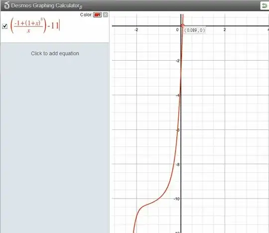

I don't know of a universal method to solve any equation. If you have the luxury to choose any method to solve an equation, and you are not particularly interested in advanced math, you could try to plot the equation either by hand or use free software on the net. to give you at least a starting solution.
For example, your equation
$\frac{(1+x)^{8}-1}{x}=11$
looks like this when plotted. enter image description here
Using plots of this sort only shows real solution (not complex ones). In this case $x=.089311$ is a solution to the equation (good for 3 digits after the decimal point).
